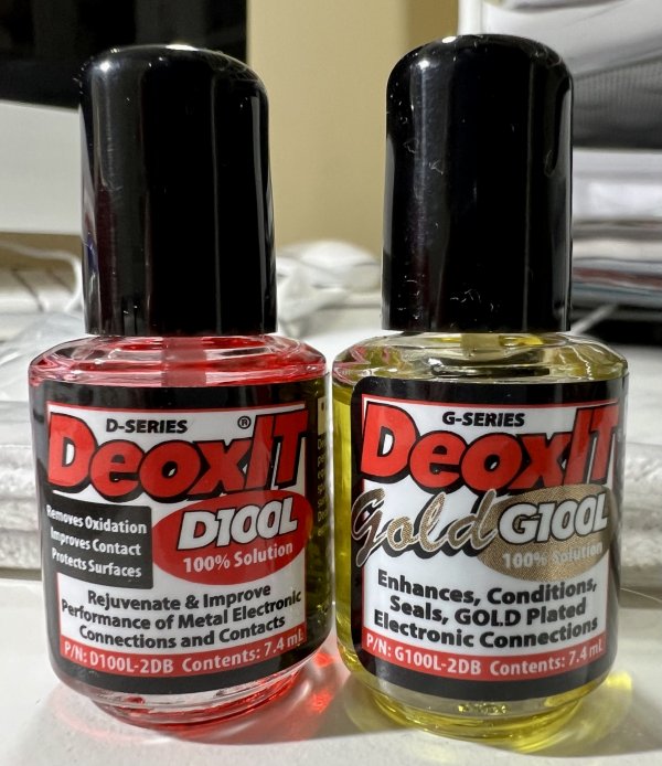

My system maintenance reference has been always Stirling Trayle.
Here is his link if somebody’s interested:
https://www.audiosystemsoptimized.com/
I followed his work in some systems, specially in Audio Exotics Showrooms.
https://audioexotics.vanillacommuni...-the-world-renowned-audio-system-optimiser/p1
Actually i’m introducing some Esprit Silver plated cables so i asked Richard about cleaning. Answer: be sure to avoid residues with IPA whatever liquid you use.
So knowing Stirling uses Deoxit Gold as showned in the picture and D5 in some systems i had clear how to act.
Material used:
• Isopropylic alcohol (IPA)
• Deoxit G100l
• Deoxit D100l
• Microfiber cloth to clean accesible parts.
• Pipe cotton cleaner for small connectors (iec, xlr…)
Method i used.
- Cleaning connector with IPA to remove superficial dirt.
- Dry it with cleaning cloth.
- Once it is dry and clean apply D100l to do a stronger cleaning to remove every type of corrosion, oxide, etc…. (IPA doesn’t do that)
- Keep D100l during 5 minutes to make its work.
- Cleaning again with a dry cloth the D100l rest liquid.
- Apply IPA again to remove D100l residues.
- Apply G100l and keep it 5 minutes in the connector.
- Clean softly with a dry cloth.
I think this steps are very recommended to get max effect of Deoxit.
