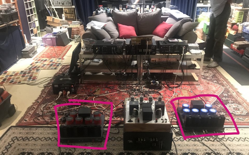

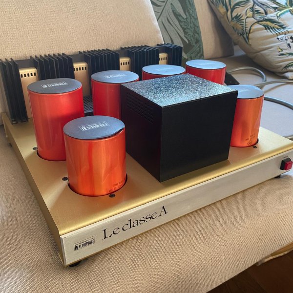

To ask a stupid question, what are they in the picture? Looks like monster caps on an amp.
should be two hiraga super class a amp replica left and right side. 20 watt class a
The capacitor is chosen to be too large so that the amplifier circuit has no influence on the power supply, regardless of the load. Many people also use car batteries as energy storage together with the capacitors.IMG-20201213-WA0003.jpg
The capacitor is chosen to be too large so that the amplifier circuit has no influence on the power supply, regardless of the load. Many people also use car batteries as energy storage together with the capacitors.View attachment 132834

Original Jean Hiraga amps are rare these days, but there are plenty of DIY plans online. The problem is getting hold of the original transistors used, which are now traded like gold. But there are certainly some good replicas.
Accu version hiraga amp over 1 farad capacitors+ two car batteries 20 watt sounds phantastic View attachment 132885
