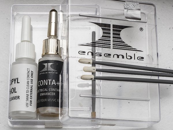

Ha, Yes the Sonic Ablutions procedure??
Well after 36years--finally ran out of this--
Since tested a few and this came out the best so far--
