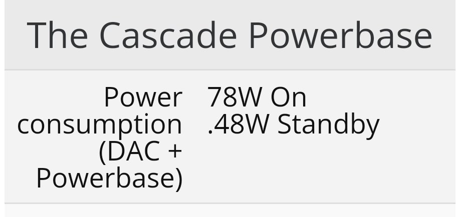

Another clarification of the technical specifications already posted for the Cascade is the power consumption:
Is the Standby power consumption = 0.48W or 48W?

Looks pretty clear to me; 0.48W

0.48W or 480mW, Just enough for the voltage selection circuity and front display.
