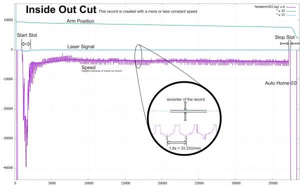

You might find this interesting...
In the past weeks we have made a few small improvements.
We have integrated a PID controller into the software.
This enables us to read out the course of the grooves even more sensitively.
We have played many records and empirically found the best setting.
Here is a measuring protocol of an Inside Out Cut record.
The scales at the bottom and left have no values. They are for internal evaluation only.
All linear tracking arms that are delivered will get an update via internet.
Thanks for your attention,
Rainer
