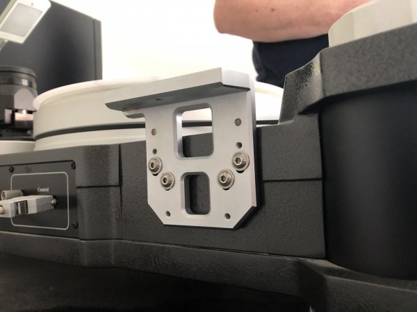

New tonearm base for TechThe Air Force Two
Here I present a new tone arm base for a TechDas Air Force Two.
It's a custom-built for a very special customer.
TechDas had expressed its doubts and concerns in advance.
We have now proven that it can be done.
The milling work is already finished, and everything fits like a glove.
In two weeks another new Dereneville DTT-05 will be launched again.
Then I will also present pictures of it.
A happy Easter to all of you
Rainer

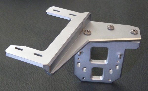

Well, I promised you some pictures. Here they are.
Making the special tonearm base was a little tricky. But as always, the work leads the way.
Here are some pictures of the milling work.
Thus, 2.6 kg of aluminum was turned into a 400 gram arm base
Then the surface was than nickel and chrome plated.
So everything fits together very nice.

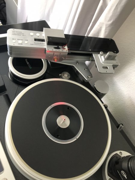

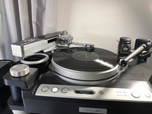

And here now the picture of the German - Japanese "wedding"
Everything fits perfectly because there are enough possibilities to calibrate everything to 100%.
The sound result has fully met the expectations of the customer.
All in all he was very happy and said: this is his early Christmas present.

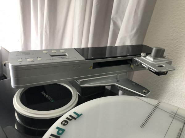

Here I would like to present you a few more pictures of the assembly.
I think the pictures speak for themselves.
An important tool which I have developed myself.
Special adjustment stencil with a line laser. This is aligned exactly to the center axis.
