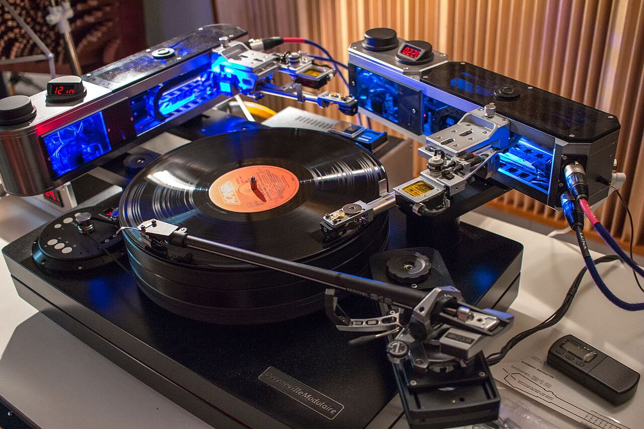

Combinations of three tonearms ...
I listened the first combination in Munich MOC 2018 with Tedeska cartridge.
Difference between the Derenville and SME was important even if on SME a more expensive cartridge was used.

Thanks for the pictures Bob.
That was in Munich at the High End show 2018
Together with Thöress Amplifiers and Tedeska Pickups it was a very successful event.
Michael Fremer also visited us on the first day. He was visibly impressed. :)

Our LT arm is actively controlled. The ones you mentioned are passive arms.
With all these passive LT-arms the small filigree needle has to do all the work of the feed.
It has to push the masses of the tonearm and all the tubes and cables.
The cables are made very thin to reduce the resistance. However, this can lead to radio interference.
Our tonearm, on the other hand, has shielded balanced high-end audio cables with XLR connectors.
The tonearm is basically built like a rotary tonearm. The pivot point is actively guided and driven along.
The high precision distance laser monitors the 90 degree angle 100 times per second.
It permanently reports to the electronic control, which monitors the angle of rotation
always remains constant with 90°.
The filigree needle lies in the groove only with the specified support weight.
There is no lateral force at all on the groove flanks.
Please have a look at the graphic in my 2nd article.
https://www.whatsbestforum.com/threads/dereneville-linear-scanning-of-the-grooves.28801/
With our principle of active linear scanning we can give the tonearm itself sufficient mass.
An MC system with low compliance can get all the information out of the groove - even the deepest bass in music.
I miss this excellent sampling of the very low frequencies in many passive LT systems.
They can't reproduce this because they have too little mass due to their construction.
I hope I was able to answer your question satisfactorily.
regards Rainer
Thanks Rainer,
It is true that with the passive arms you might have radio interference if you do not take care on shielding etc.
On the other hand with the active arms you have a lot of active parts having impact on the arm tube and on the needle (energy transfer).
I remember the Goldmund arm, which was really insufficient. I had it and sold it.
Active arms control one aspect of the scanning but maybe also opening a handful of other issues on tracking.
How many times have we seen the Thales improving it’s design? It is always a compromise.
Nevertheless your design is very interesting.
Best
E.

.....with the active arms you have a lot of active parts having impact on the arm tube and on the needle (energy transfer).
Yeah, you're right, we know all these problems.
But we have all solved them perfectly. And it took almost five years for development.
I also wrote that in my story.
Today we are happy to present an active LT arm that plays far away from Goldmund and other LT arms.
To date we have five very satisfied customers. And there will be more.
But we only build six of these LT arms a year. And we have limited them to 24 pieces.
And once again: the operation is really child's play.
All components are also used in industry and have proven themselves many times over.
So there is no reason to shy away from it.
When the new LT arm is ready I will make a short video to show how easy it is.
You live in Munich - why don't you take a flight to Paderborn and visit me - I cordially invite you here.
I will also pick you up at the airport, if you wish. Afterwards you can honestly report to the users here.
kind regards, Rainer
