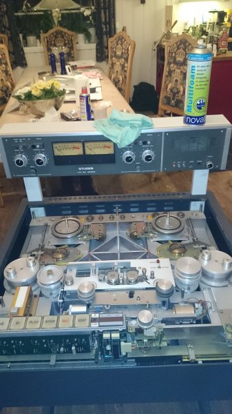

since one never knows how long the desert island stop will last, i might as well play it safe....
machine was calibrated by my tech when I picked it up so only
a little TLC is needed as usual

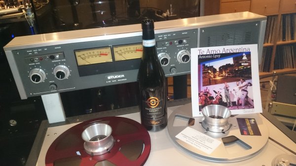

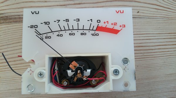

unfortunately one of the VUs inner scale panel had a broken bit
anyone one where to get new panel? it´s meant to unscrew, so guess spare part...the meter itself works fine

just lacking a few lightbulbs and I´ll change all bearings as I´m about to do with the other one

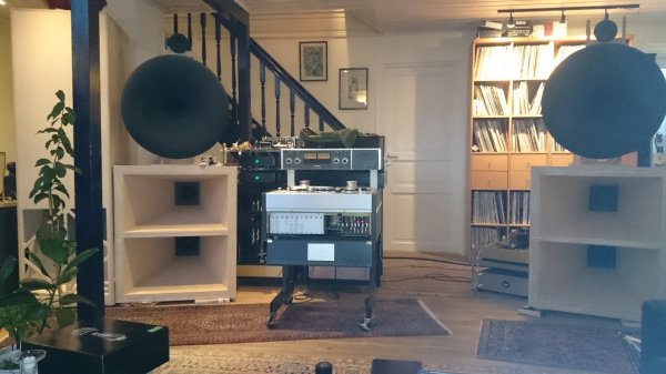

anyway here it´s playing Mark Colby quartet........
Beautiful machine!
I've seen vu meters on eBay. I have a spare meter bridge I need to sell as well.
thxs
Yes I´ve seen it as well
glued it so far and not visible
