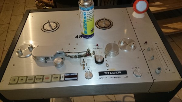

Congrats on your newest addition to the family! :)
thxs

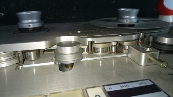

btw butterfly heads, but I guess \I´ll survive
probably getting my UltraAnalogues tomorrow....perfect timing
best
Leif
Looks like an old BBC unit. The machine and capstan look in reasonably good shape. I'd change out the pinch roller, clean it up some and go from there.
