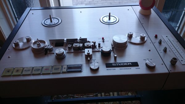

just finished cleaning it up on outside, under and around headblock, tape path and even inside and under tape tension sensors etc
looks quite nice now....:cool:

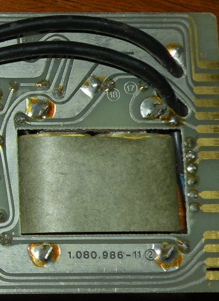

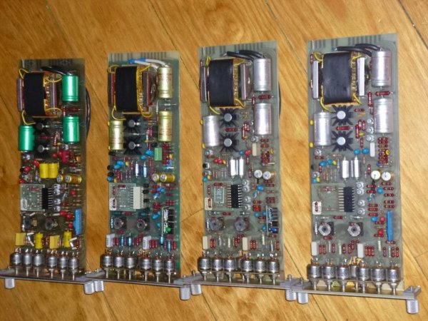

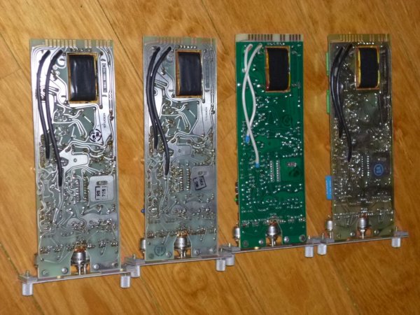

This is a repro card from a very old B62. Note the card number and that this is from a B62. . As you can see the Plessey caps are stock. However the A101 is the old black model where your machine has the newer blue model. Also the tantalum caps in your machine appear much newer. Very perplexing as I have early A 80R cards here with the newer A101 but then Frako caps in place of the Plesseys

All caps in my machines were replaced.Not for sonics but it was found at the time that most were either disfunctional or far off specified value.I have had Frakos explode in the transport section but not in the audio .
A 101s are known to fail( I have had one A101 fail). That is why Studer published the circuit as failures were expected. I cannot comment if current production sound better. I elected to not change any cables in my stock A80s and left the transformers in situ. Studer transformers are known to be of good quality and so was the wiring used. You do not want to pick up a hum in an A80!
I would however stongly recommend modifying the machine to disable the stereo/mono switch. This is known to be source of trouble and does sonically degrade the machine.As for the heads,I have machines with both butterfly and 2mm heads and can happily live with either.
Finally there is a wonderful bit on a service site ( where escapes me now): It is a quiz as to what is the best sounding mastering machine ? The answer-not a Studer or Scully or Ampex or Lyrec or Telefunken or whatever, but a well aligned one! There is a lesson in there that I certainly learned the hard way. Always get the machine working optimally before starting modifications.

Just to complicate thinks - repro boards coming from four different A80's: One board has red and blue capacitors!
I recently acquired a box filled with NOS blue A101's and a lot of the new replacements (ex BBC stock), but I haven't got the time to test and compare them.

(...) Studer transformers are known to be of good quality and so was the wiring used. You do not want to pick up a hum in an A80! (...)
An acquaintance of mine got two old A80 repro cards in poor condition from eBay just to get the transformers for a DIY project. He measured them and was very pleased with the results.

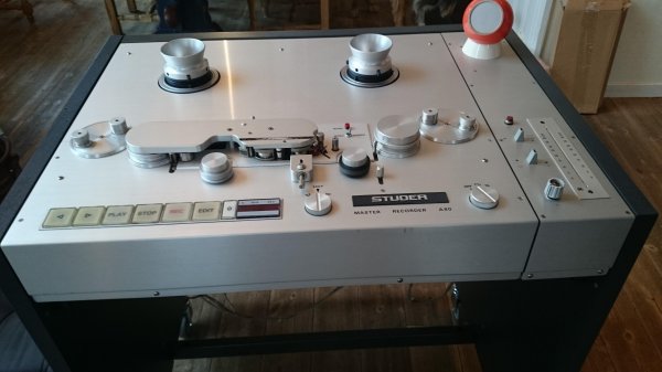

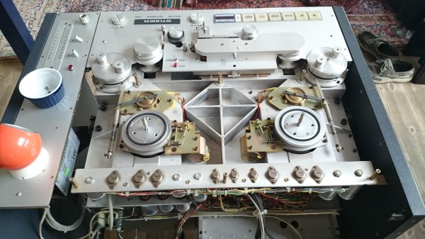

A80 cleaning session
hello folks
starting to get more familiar with the structure of the A80
got off both top-covers and cleaned up
left tape sensor was not a free feeling as the right one and the cause was a loose damping pad under the top cover
glued it back on
also used the opportunity to change all topcover screws to A4 ss
any particular parts that needs to be oiled?
haven´t checked the enormous service manual yet :rolleyes:
A80 topless 2014-04-05 14.44.04.jpgA80 toppless front 2014-04-05 15.32.28.jpg

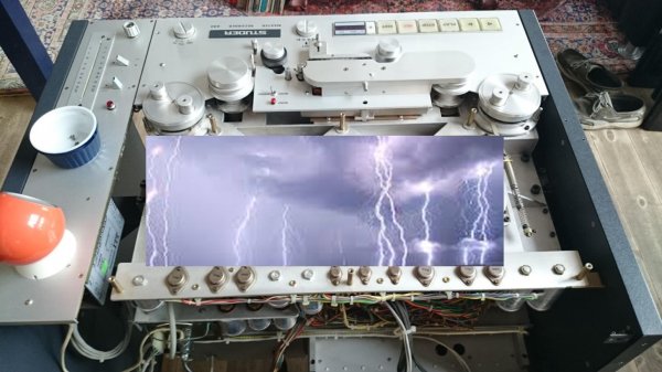

Although these pictures are great looking, every time I see an open A80 I think about thunderstorms and lightning! Remember those beautiful transistor cans are connected to the collector of the transistors and any metallic tool or object falling on them will probably make a short-circuit to ground or between them ruining your precious machine. Every time I open my A80's I always cover all the transistor cans with a long 6 cm wide plastic strip, scotched at the tops.

hello
yes I´m careful and it´s not ben powered when open
nice "photoshopping"
I´ve read loads from tape project and other fora
if you can take another picture.....

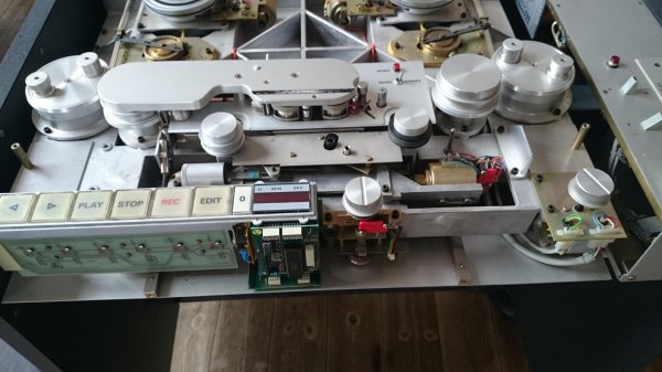

more angled view
finally playing in system :cool:
Rossini from UltraAnalogueRecordings....my favourite so far....
due to short available cables it is positioned rather akward, but I´ll move it over to the left in front of the hornsub later
