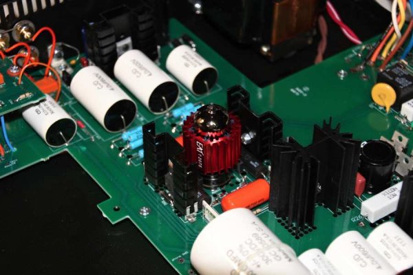

I just received my EAT EC88 Tube Diamond series today. No gold pins. Sent an email to ask about them and here is part of the response below. Looks like the newer ones will not have gold pins anymore.
Also the Red part is not glued on and moves easily. I did not think of removing it to see what the actual tube looked like. I have only just put it in today and not had a chance to sit down and have a real listen. Was using a cryotreated NOS 6DJ8 MATSUSHITA before this one and thought it was pretty good and very quiet.
RESPONSE:
Thank you for purchasing our EAT cool valves. You bought a latest production. We do not coat pins with gold composite anymore. According to our tests it has not really different condactivity properties.

The cool dampers should just slide off, mind the silicone spacer locations though as they determine correct 'tension' on the glass, important for good damping..
