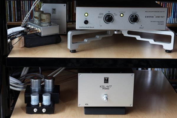

Hello Tang,
I can make this recommendation for you it is versatile, super performer, and as Thomas would say, “Made with a good brain.”
This one by Kondo, the KSL-SFz SUT.
Kind Regards,
Alan

Cinemag
Altec 4722
Auditorium homage
Sivercore
Ypsilon
Kondo
EAR
Get in touch with Dave Slagle at Emia or Intact Audio. He can wind one specifically for your cartridge in either copper or silver.
Beau
Step ups are in my plan. Choosing which step up depends on the carts I am intending to use with? or any particular one you could recommend, E.
Kind regards,
Tang
Man I would love to try a WE Tranny like that :D
That Silvercore doesn’t look to shabby either. Wish the Silvercore were still available. How is the Ortofon ST7 ?
Me too. Got to wonder if the WE is just another hyped WE product just to keep pushing up the price.
There are a lot of great step-ups out there.
