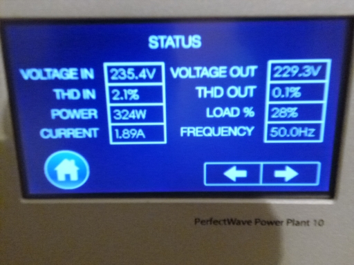

The PS Audio P10 arrived a few hours ago. I will post on it after listening during the weekend.

microstrip
