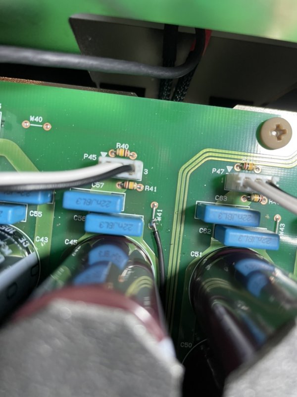

My new PS1(esoteric K1x powersupply) also has the circuit design problem of ground loop .Be careful!!

Hello, I am new here. I am waiting for a K1X I ordered a few week ago and I am planning on buying a PS1 in a few months. Could you elaborate on the issue you encountered with the PS1? In particular, do you know if Esoteric is aware of the problem and if they fixed it?
Thanks a lot!
If your system uses single-ended(RCA) connections, will cause your speakers to produce a noticeable hum due to the ground loop.
My dealer has reported to the Esoteric factory, and a jump cable(black wire) was added under the instructions of the Esoteric factory.
