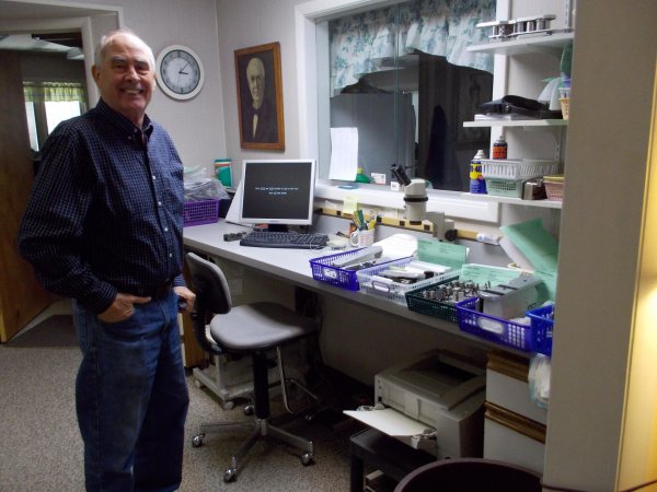

During a visit to John French (JRF Magnetics), he mentioned that Studer's tape head manufacturing location burned down in the early 2000's. Wonder if they retained a stock of heads; rebuilt the operation or are using some other headsJohn in Receiving.jpgRelapping area.jpg
Pics are of John in Receiving and in his Relapping Area. His wife, Cookie owns the company and handles the business end. Sweethearts both!

During a visit to John French (JRF Magnetics), he mentioned that Studer's tape head manufacturing location burned down in the early 2000's. Wonder if they retained a stock of heads; rebuilt the operation or are using some other headsView attachment 15756View attachment 15757
Charles
Thanks for sharing the pics :)
It is said no one is irreplaceable but between John French, Greg Orton and Jay McKnight they come very close!
