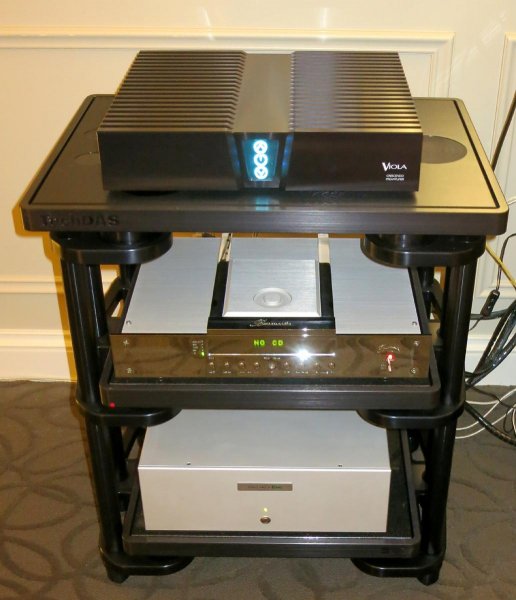

Preamp and CD Player - Viola Crescendo and Burmester 089. The air pump and motor controller for the TechDAS Air Force One is on the lowest shelf.
