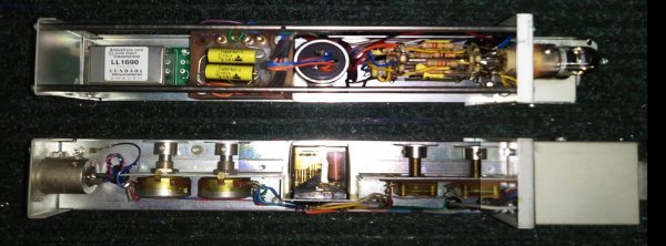

The C37 was originally owned by RCA in NYC and they tinkered with a few things. The machine uses 4 relays for NAB and CCIR and specialized EQ. All the caps are German Roderstein / Vishay, resistors are all Low Noise metal film 2%.. I am trying to keep it as stock as possible.1026181345ab.jpg
I was talking to my tech and found out some real interesting improvements that can be made to the record and playback preamps. So I told him to do his magic....exciting. There are several impediments in the signal path on all the preamp designs which are now 60 years old. So the result will be a much cleaner and more powerful signal which will enhance the sound of tube compliment, which is excellent and with the improved EQ, bias levels.

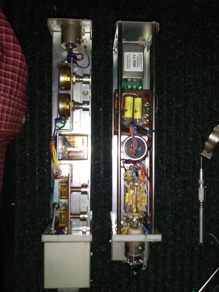

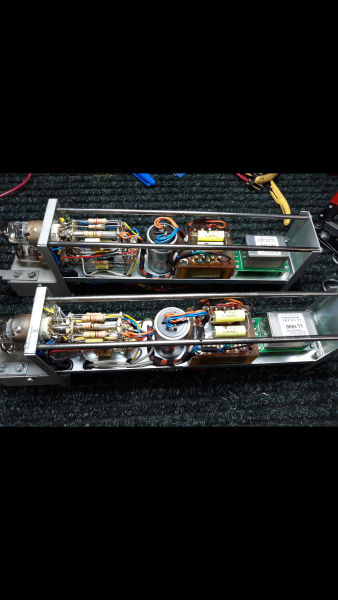

Here's the record preamps with swapped out transformers replacing the inadequate Beyers. Just one of the upgrades Dan is doing for me. These transformers will make a overall big difference and these had excellent specs.1101181625.jpg
With New capacitors.

Did away with the paper and oil Bosch 4uf caps..FDA99498-9205-4A9E-9E0F-51D8869FC027.png

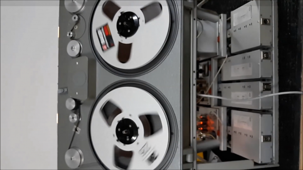

Here is video I made stitching the small piece together.I over dubbed the music “Stairway to Heaven”. I currently feel that way, as I waited so long, it’s a gift from heaven.Coming home soon.

You may have guessed I had some issues with one of the playback amps. Still do but almost done. The EQs were pretty good Left channel is flat 32 Hz to 20KHz, plus/minus .5 db. Right channel is the same up to 10Khz but rises to +3 at 20 KHz. Most of the issues were around the speed relay and the relay socket. This relay is a custom, very non standard relay. It has 4 form A contacts and 2 form B contacts. Never even heard of this before. Normally they come with only form C contacts. I was able to rebuild it using a coil from a standard relay. I had to replace the socket as well. In order to find these issues I had to make a set of extender cables, power/signal and head connections, so I could trouble shoot the amplifier on my bench under power. I will include them in the shipment back. I hope to have the right channel hi end issue solved, over the weekend.
