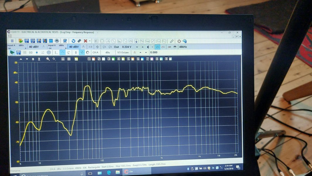

Plus minus 2 db 200 hz - 12 khz with slight roll off to 20 khz .
With Mls measurement .
With Log chirp measurement basically flat
Ivory speaker with ringradiator
First is Mls method , second measurement is logchirp

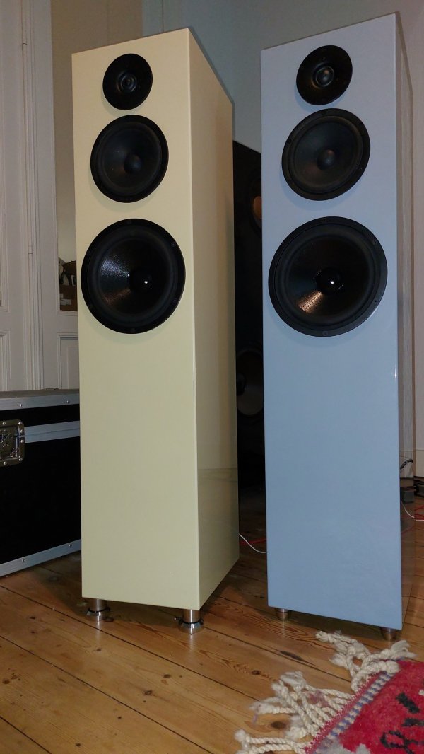

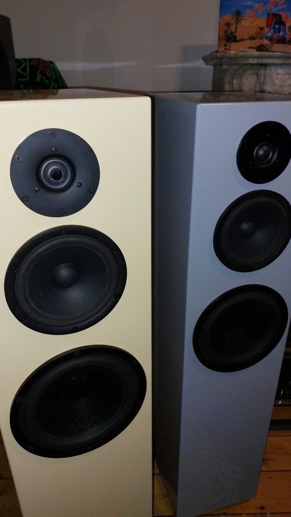

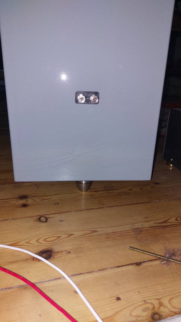

Finished design XPE-S ( small )
More then happy with the sound despite doubts about the reduced cabinet thickness 13 mm instead of 40 mm
Angled internal walls to reduce/ diffuse the back wave seems to work just fine
My favourite tweeter so far is the scanspeak revelator ringradiator and soft dome version , no need to go berylium imv.
The most transparent speaker i ve designed to date, series filters really work .
HPL rules best cabinet material period :cool:
