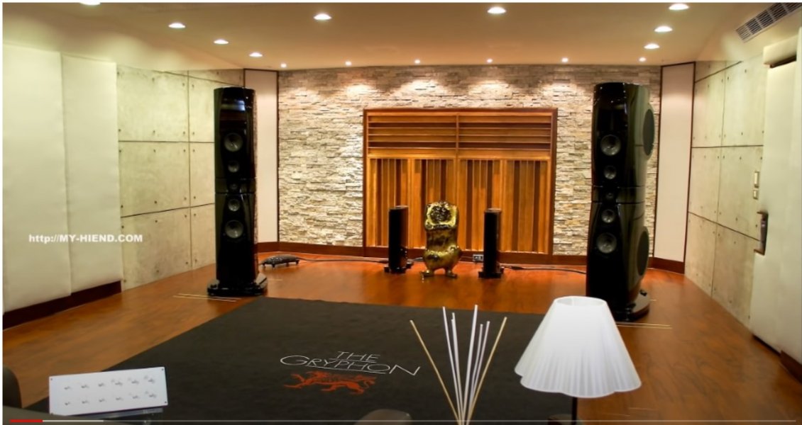

A system / room i always looked up to was this system , it played koyaanisqatsi / prophecies on you tube.
(I dont think it was played through the speakers )
I thought id make a vid playing the same music through my system .
If i would change / upgrade it probably would be Gryphon Apex or Robert Koda
And the best Rock and Roll band of all times AC DC Live wire with Bon scott .

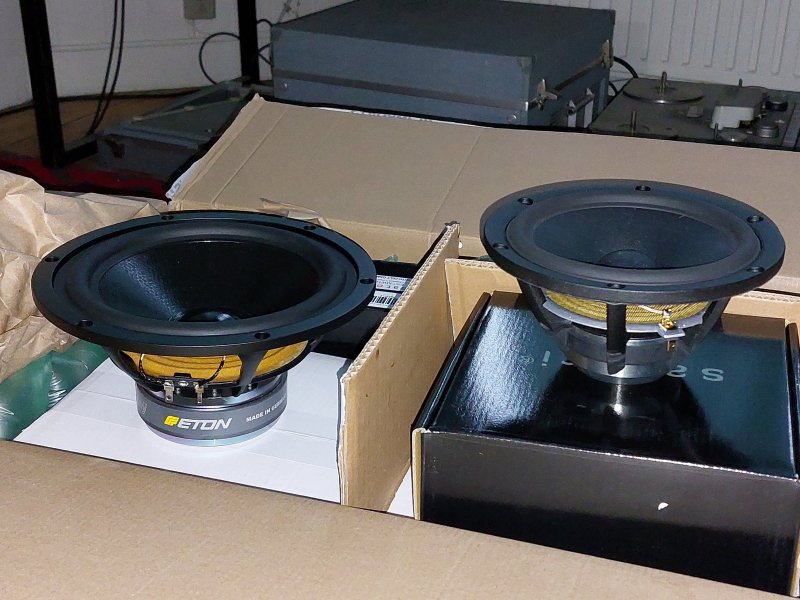

20230328_185231.jpg All the parts have arrived for the smaller cheaper model.
Eton 8 inch for the bass and paper for the mids as usual.
But different more sophisticated drive systems
Which will result in a small affordable 3 way , probably a closed system/ easy to place
The papermid membrane is made of egyptian papyrus according to the manufacturer , whether it actually sounds better has to be heard

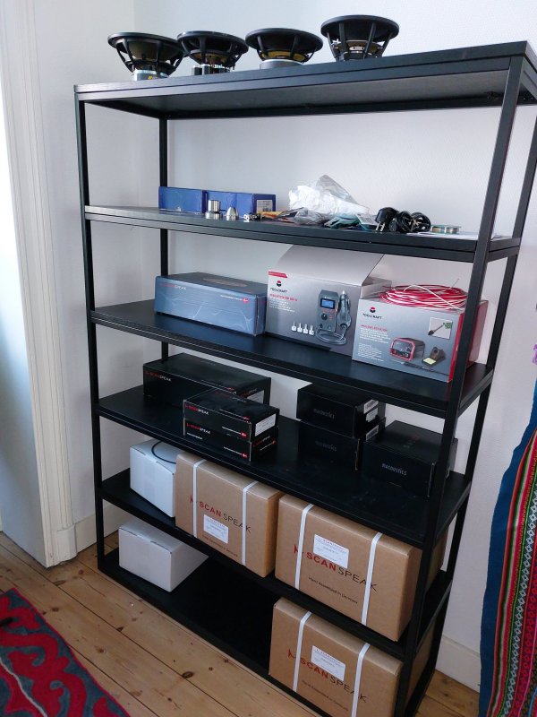

Next up testing of midranges.
I ve got almost a small factory now . :)
Im testing one nomex kevlar membrane and 3 paper mids varying from 160 to 800 euro a piece.
This is the fun part .
I have listened to an enourmous amount of drivers / speakersystems over the past 2 years and although carbon fiber / hard membranes sound very articulate and clean , i love slightly forgiving /absorbing paper ( The British sound ??)
I ll also test membranes which have a foam surround / flatter response and dont have the typical 2-3 db dip due to the rubber surround resonance in the 1-2 khz area
Also i like to hear if the elliptical voice coil results in sonic benefits / better transient response or not.
It should for the price .
Plus i m gonna experiment with larger membranes and a lower X over point ranging from a 6 inch currently to 6,5 , 7 and 8 inch .
Midranges are the heart of a speaker

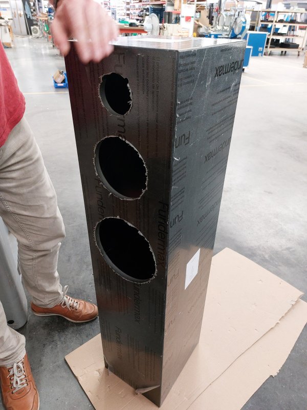

Arrived from the machine shop
ll be using a new ultra hard compositie material
Best bang for buck speakers i have ever designed .
2 new models.
Wooden loudspeaker lovers need not Apply.

New basic ( low cost) design , 3 way closed system in miter ( CNC machined )
Unfinshed , it will get high gloss piano laquer
Made of HPL which is layers of Kraft paper drenched in phenolic resin then heated / pressurized.
Paper damps resonances extremely well

What are the speakers
