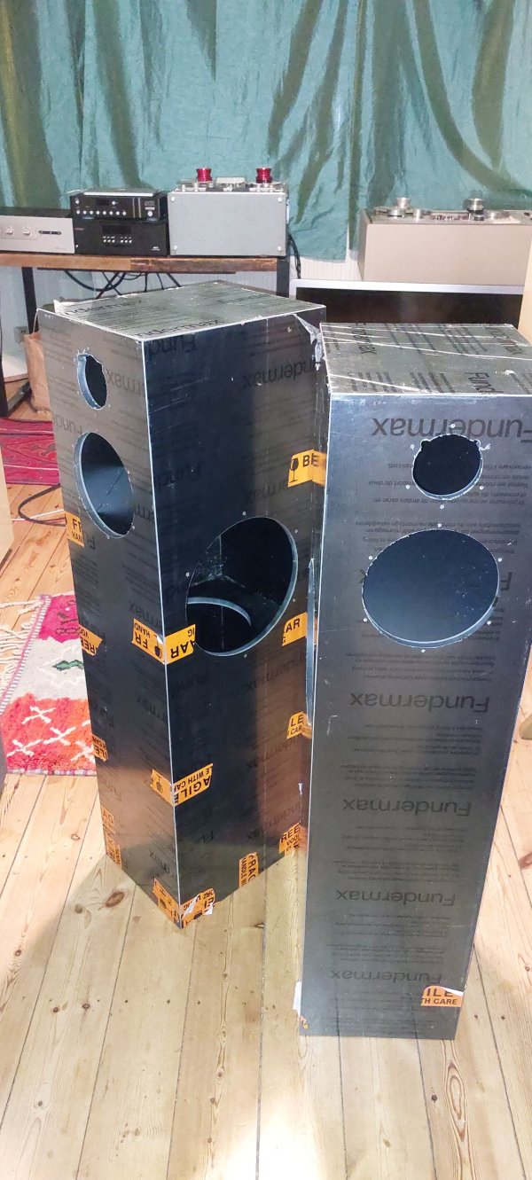

Picked up my repaired studer B 62 VU .
And finalized my new speaker design before i left to the US for work .
For this one i aim for a +- 1.5 db Fr due to the foam mid range surround use
Off course paper and 7 inch this time.
Scan speak sliced paper and a ScanSpeak ellipticor version .
This allows for a lower X over point .
Again angled internal walls to reduce the back wave .
Series X over filter
11 inch Eton woofer side mounted almost on midrange height .
Hpl off course and a closed system.
Bass extension will be in the low 20 s

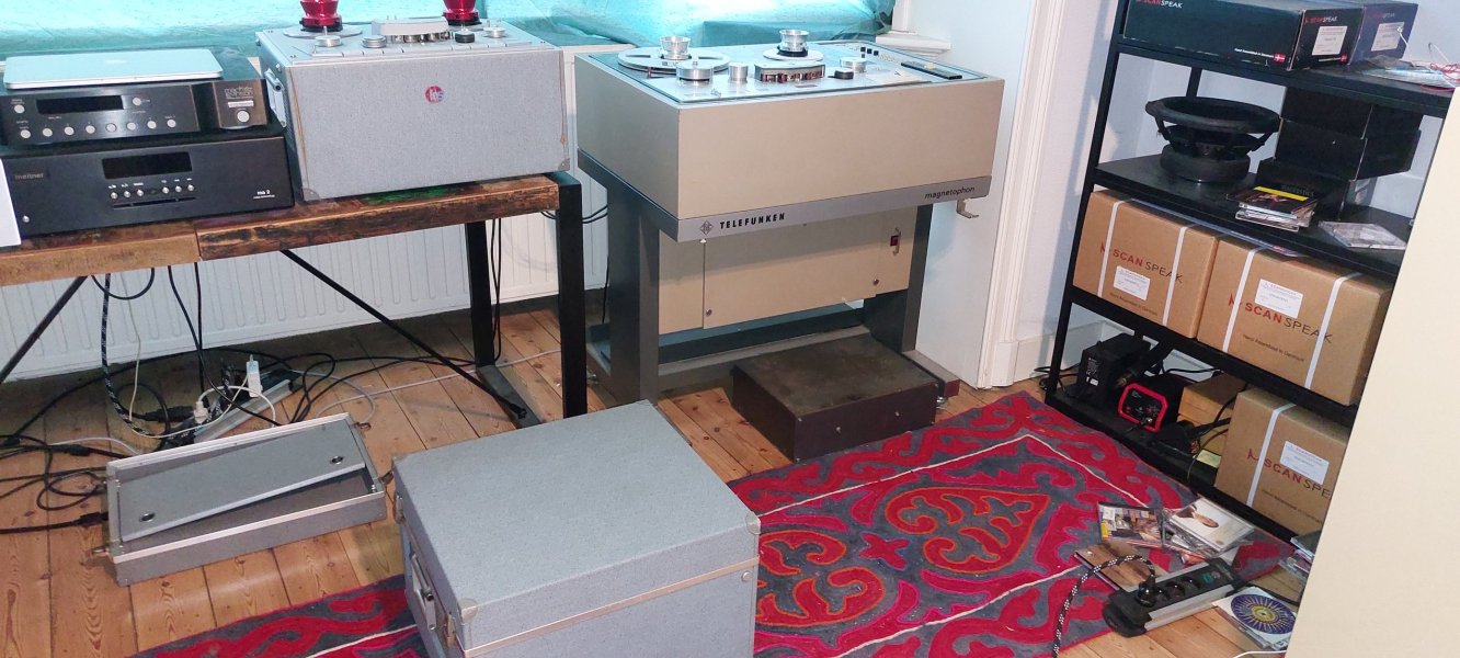

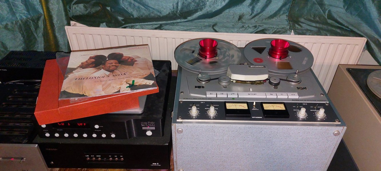

Spinning!!
Really happy all my 3 machines are working correctly.
Doing some recording this weekend .
Keith jarret koln concert 1975 ECM recordings Munchen.
Martha Argerich 1965 Chopin No 1 studio Abbey road London
The best tape i have might actually be the
Keith jarret Koln concert recording .

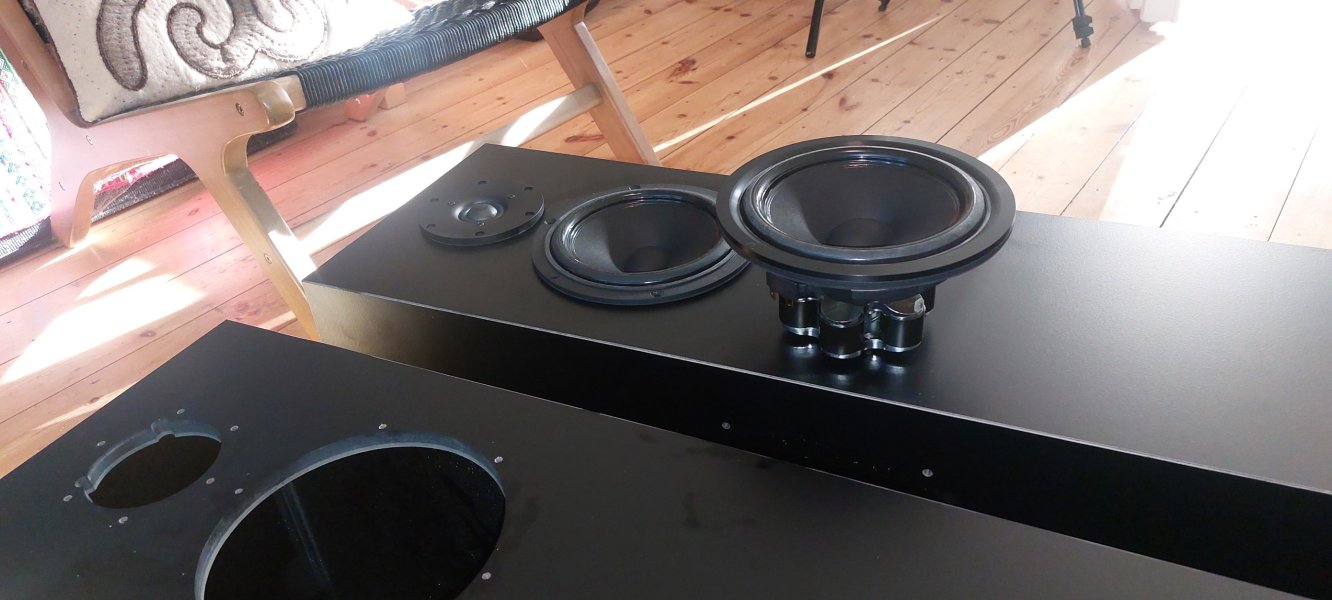

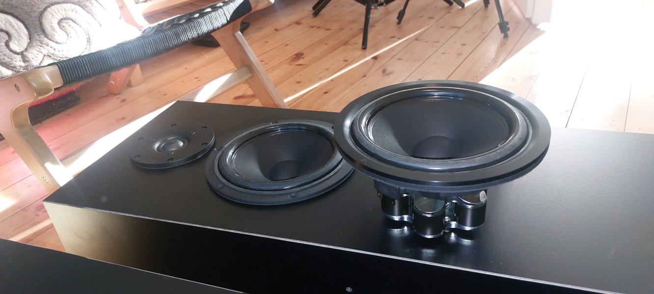

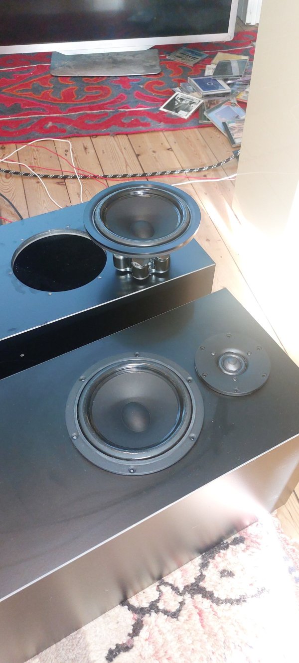

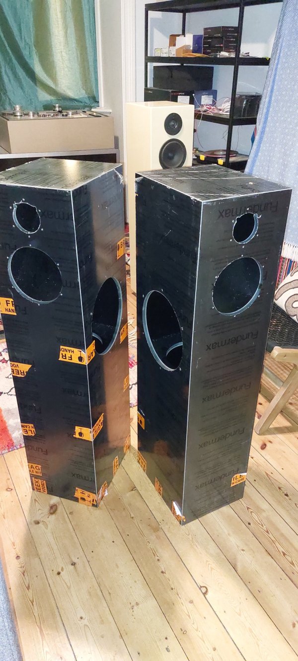

New model time , ....
Same composite material
Side firing 11 inch woofer Eton.
7 inch paper mid with foam surround .
Ultra flat Fr , 3 way , 92 db eff.
22 hz bass extension .
Angled internal walls/ closed system/ Series X over

I will have 3 models in the end :
Next year , 2025 they go up for reviewing / advertising
The 3 way floor stander with front firing 8 inch woofer .( model 1 )
The 3 way with side firing 11 inch woofer ( see above post ,Model 2 )
A passive sub with 12 inch woofer is on the way . 92 db eff.
( And the XPE model on request )
A high mounted side firing woofer gives a different dispersion / radiation pattern , i like it a bit more i think .
There are no cons of either model , the higher you go up in the range the more bass output you will get .
Model 2 has more internal volume combined with a 11 inch woofer and 7 inch mid ( high freq units are the same )
A speaker which goes both lower and has more membrane surface will be able to scale up more /produce a bigger sound
Model 1 can be combined with 1 sub
Model 2 needs 2.

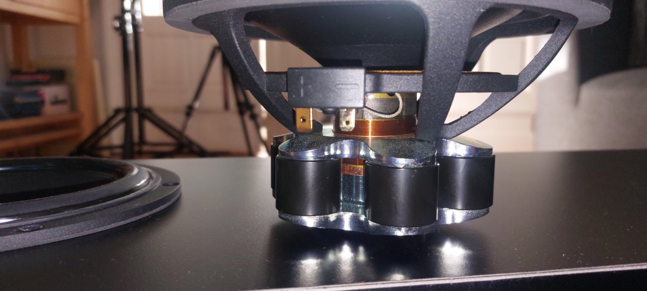

Scan speak ellipticors which are pricey and have a real nice elliptical voice coil / magnet system
Ellipticor.
But to be honest despite the big price tag i have not heard much audible advantages in speakers that used them , i heard a few in munich .
But who knows well see, price / complexity doesn t guarantee good natural sound .
The other model 2 / 11 inch woofer speakers will be delivered end of december and i will compare with the standard ferrite magnet / sliced paper cone mid unit .
Woofers are like usual Nomex / kevlar , but .....side mounted
