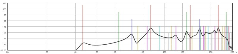

You're going to have difficulty getting uniform bass in that room I think. Here's a room mode calculator that shows quite a few modes that could be problematic--43 Hz, 49 Hz, 73 Hz, 75 Hz.
REW has a built in room calculator and the ability to see the room response when moving the speaker position.
strange that focal doesnt seem to make that many problem when positioned correctly, thanks for the link I will further serach what I can do to my room before speaker upgrade
