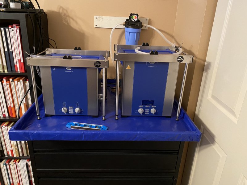

On this topic, but not about the HumminGuru, I added a rinse cycle to my work flow.

Dminches, you’ve kind of missed the whole “table top” small form factor approach. But, we are audiophiles are we not? Nothing exceeds like excess. :p
Those unit just did not cut it for me. Putting this all together with the help of @tima was a lot of fun.

Is the wall mounted filter a sediment filter? You might want to add a mixed bed deionization module if your tap water TDS isn’t too high to start with.
(I’ve owned a water purification company for 20+ years.)
Nah - he jumped over that and went for state of the art. David's setup cleans five records at a time while it rinses the previous five he just cleaned. His Elma ultrasonic cleaning tank (right) cleans at 37kHz and 80kHz, so no compromises there. The cleaning tank has its solution continuously filtered simultaneous with its ultrasonic operation. That filter ia a Flomax/Watts FPP-0.2-975-DOE 2.5” x 9.75” DOE, 0.2 micron (absolute) polypropylene cartridge. The rinse tank (left) provides 37kHz ultrasonic action during the rinse cycle. Both tanks include timer, heater, degas, sweep, etc.
