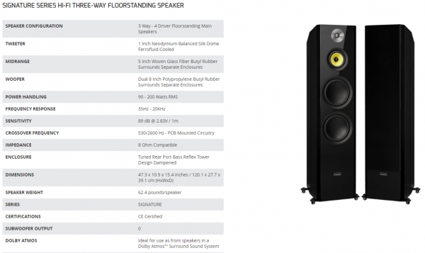

My speakers say they are 8 ohm compatible but the speakers themselves say they are rated at 4 ohms. The Onkyo TX-RZ830 for example has the following specs:
All channels 250 W/Ch (6 ohms, 1 kHz, 10% THD,
1 channel driven)
120 W/Ch (8 ohms, 20 Hz–20 kHz,
0.08% THD, 2 channels driven, FTC)
Dynamic power 250 W (3 ohms, Front)
220 W (4 ohms, Front)
130 W (8 ohms, Front)
So according to this, it only dynamically supports 4 ohms. Is that going to be a problem? Well the speakers are 8 ohms compatible, wouldn't it be better to run them natively at 4 ohms?

If you can see if you can find a technical review for this receiver. it will tell you exactly how much power it delivers into 4ohms rms. Most solid state amp have no trouble driving four ohm loads. The better ones might even double down(POWER INCRESES AS THE RESISTANCE DECREASES).RMS is the only meaningful rating.
In general a quality amp section inside an AV receiver, into two channels driven, with around less than 0.1% THD, and say delivering 120 watts into 8 Ohms would be able to roughly deliver 180 watts into 4 Ohms. But most are not the generality in quality amp section, more so today with AV receivers weighting 20, less than 30 pounds.
At long last, I finally have the model number / specs of the receiver my job will send me for free. Integra DTR-30.7 This seems like it would work very well for me but please scrutinize it and let me know if it's missing something that I need. As a refresher, the following are my speakers:
Thank you!

Is there any advantage to run the speakers at 8 ohms vs 4 ohms? Seems like you would benefit from running it at 8 ohms and save my amplifier some work considering my speakers are 8 ohms compatible.

Run the speakers @ 8 Ohms, you'll get more dynamic power and this Integra can provide it.
Even if your speakers were a 4 Ohms load the Integra is more comfy @ the 8 Ohms selection.
Always use the 8 Ohms default setting (6 Ohms default value here in the Integra 30.7 - so just leave it there).

You know, I don't get lucky often...but I'll take this as a win! And I actually feel like I'm starting to understand some of this stuff too. I plan on Bi-Amping my speakers because they support it and so does the amp - might as well take advantage of that extra performance until I bump my configuration up to 7.1.

1. Don't biamp, even if using five speakers @ the beginning.
2. Don't remove the jumpers of your speaker's dual sets of binding posts.
3. Simply single-wire them using the lower set of binding posts.
Why? You won't gain anything.

I copied those numbers verbatim. Make your own decision. 10 % is audible. Nominal impedance is like an average. Have you ever seem an impedance curve, ?
If you have selectable impedance great.
Greg, in many Onkyo/Integra receivers, on the onscreen GUI menu under Speaker Setting, you have a Speaker Impedance choice between two selections; 6ohms (default) and 4ohms.
In most cases (vast majority), including Jonathan's particular case with his speakers, the 6ohms (default) selection is the correct one. He doesn't have to change anything here if the Integra model DTR-30.7 offers it.
Different countries could vary in offering that feature.
But I had few Onkyo receivers in the past, and in Canada that Speaker Impedance selection was offered...same as indicated above...between 6 and 4ohms.
I had speakers rated @ 6 Ohms (dipping to 4 Ohms @ few spots) and I always selected the default setting...6ohms.
* Selecting the 4ohms setting would greatly diminish the overall power and dynamics.
It's best with the 6ohms default selection...for 99.9% of people. I know so, from real experience.
