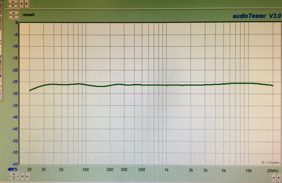

I have a new toy coming soon. Check out this frequency response from a cassette tape. I say not bad.

My double speed cassette is close to done. This is the frequency response. I think is pretty fantastic for a Maxell XLSIIS. Hopefully some other tape heads will get one.
