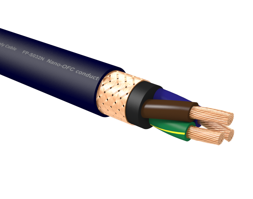

A dealer offered me these ones:
While an audiophile friend suggested me this one:
Any European tech guy/electrical expert can give me some suggestions?
Any member here who can share some experience with 220V in wall audiophile cables?
TIA
