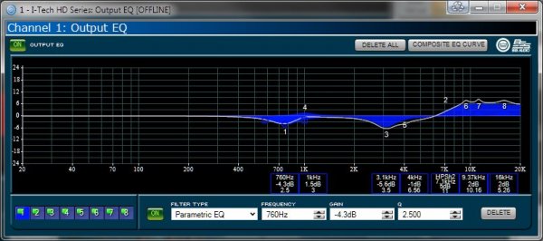

A friend of mine loaded the DSP and took some screen shots. Here is what it's doing. Any CD horn needs compensation beyond the mass break point of the compression driver diaphram. As you can see from the EQ they trade off some efficiency on the woofer to gain a bit more LF extension.
Hello Duke
The JBL dual diaphrams are unique. The VC wire in the 2216 woofer uses the special alloy to combat power compression. You can purchase the compression driver through JBL pro as it is used in several of the SR boxes and the Vertec systems. The waveguide and woofers are not for sale.

Balance of the screen shot's. There is also a protection capacitor internally on the compression driver that is an additional pole so add 6 db to the slope on the HF Composite Curve.

As Rob's screenshots show, the sound of the M2's is totally programmable. For the event last night, we tuned it to the ears of the folks who came before the show started. We did not sign off on it one way or the other :). We did whatever they told us to change in the response curve.

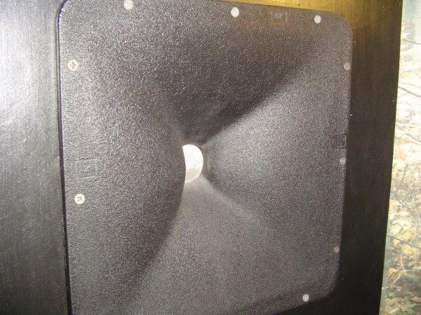

That waveguide is intriguing me more and more. It looks to me like the radiation pattern changes with angle, this because the waveguide's profile changes with angle... compare the path down one of the valleys to the path over one of the hills. Not that the pattern of other horns doesn't also change with angle, but I think the internal geometry goes through more deliberate variations here than in anything else I've seen. Obviously the team at JBL had reason to believe that was a good idea (assuming my armchair analysis is in the ballpark). If anyone has insight into what's really going on, and the rationale behind it, I'm all ears.
Harman has a proprietary and patented waveguide design software that I think is used there. Prior to that it was used in the new generation Revel speakers. If you look at their waveguides, you see very odd things like a vertical crease! The ability to deform the waveguide and yet optimize it beyond any simple curve.
That compression driver is very tempting. Heck, they all are. There's a part of me that's a bit skeptical of the waveguide, just because I can't envision how it avoids having significant diffractive effects, but not being an expert on horn/waveguide design I am also skeptical of my skepticism.
Hello Duke
I can understand your skepticism but frankly I think all this diffraction slot emphasis is not well placed on the next generation Bi-radials/Waveguides. If you look at a JBL 4430/35 measurement you can see the deep ripple in the response. Not so on the new horns and waveguides. I have first hand experience with the PT's where I used a PTH1010 as a replacement for a 2344 I was using in my active set-up.
The PTH1010 is a 1.5" 100X100 waveguide. To me it looks suspiciously like the M2 waveguide but the M2 has additional refinements. The PT waveguides all had a diffraction slot however it was nothing like the original first generation Bi-Radials. It's much more refined and does not have the ultra sharp transitions present in the original horns. I will attach a photo of the original horns used in the 4425/4430/35 the 2342/44. Compare that to the PTH1010 photo's very different transitions through the throat.

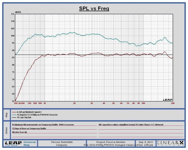

I will also attach a measurement of a throat-less large format driver on that waveguide. That is a sim as I have to make the actual networks but take a look at the voltage drive and lack of significant ripple in the measurement. That's with 1/12 octave smoothing ungated. The network is basic 18db slope, attenuation with a simple series filter to smooth out the upper octaves and single parallel notch to take out the 1-2K response peak.
