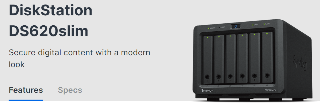

Hi Marty,
I opted for the same option as you, I took 15 TB of internal storage. But for different reasons.
If what you're looking for is keeping your audio files safe, then by far the best option is a NAS.
Backups will also be much easier.
That's good advice from Emile.
For example, you could use one of the following NAS in RAID6 (SHR2). And you could place the NAS in a different room.
Add to it an external USB drive for BackUp and some long terme Amazon backup and your data is über safe!
Losing your data in this context means you almost have to do it on purpose :)
The only drawback is getting used to the NAS. But Synology does things very well. Their system is really easy to use.
Hope this helps,
