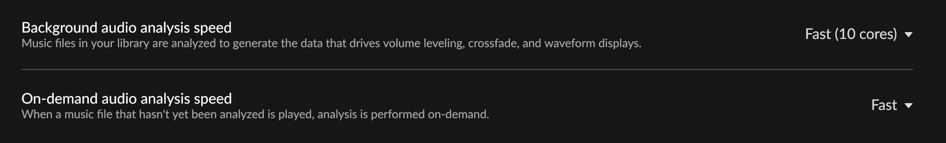

Olympus is really intended to operate in a low power regime (for obvious reasons). Roon cranking through analyzing my 30k++ library from my NAS gradually depletes the system BPS over a couple days, even with charging on (need to turn off analysis every now and then to let the battery recharge)
When Roon is doing normal playback (no analysis, etc), all is happy and can easily keep up.
That is a startling, although on reflection, perhaps not an unexpected finding. I am surprised that even with the lowest "Throttled" setting, the energy depletion rate exceeds the maximum charge rate. For those wondering what this is, it's in Roon > Settings > Library:
In my experience on the Extreme and before that, Roon's analysis (which analyzes each tracks volume level and dynamic range) is a pretty heavy process, much more so than the actual scanning of files. Luckily both the above settings can be turned off, which I've often done in the past when adding large batches of files to my library.
Emile @Taiko Audio : perhaps it would be safer to ship future Olympi with Roon configured with these 2 settings OFF. The user can later run this Throttled (perhaps over prescribed intervals) at a later time after the initial library scan is complete?
Leaving On Demand to be Fast would work as well. Analysis for a single track is pretty fast
At the end of the day, lower power and higher SQ for the long term is a huge win over first set up (for obvious reasons), so the trade off is definitely the right one. Just need to be aware if you've got insanely large libraries that take more than 2-3 days to analyze
As far as I remember Emile setting my Roon for Extreme This both options should be completely OFF as it uses tons of power in the background.
And yes it affected the sound very significantly in my system.
So I kept it OFF at all times.
I don't thing this has changed with Olympus.
Please let me know if I I'm wrong on that.

Yes, its been long recommended to have both these settings off
In the Taiko Roon Settings Document on the Taiko Website downloads page
https://taikoaudio.com/taiko-2020/wp-content/uploads/2024/07/Recommended-Roon-Settings_V8.x80569.pdf
it's step 3 and step 4
That’s possible BUT we’d need your Roon credentials to configure Roon before shipping.
However this is somewhat unexpected, 30K tracks is not that big a library, unless the files are all very large? @ray-dude do you have an estimate of the total library size in Terabytes? And it’s solved by just disabling the file analysing process?

The CPU/subsystems can indeed draw substantial amounts of power, it’s beastly hardware, we can throttle power of course, but we’d need to know what to throttle. You’d want to balance SQ performance versus minimal necessary functionality.
A guide we can do of course but scanning a library I’d consider basic functionality so some more data input would be appreciated!
Its a simple toggle on/off regarding Background Audio Analysis Speed/On-Demand Audio Analysis Speed: Go into Roon Settings/Library scroll down to the last two and toggle off.
I'm more concerned with a relatively small amount of tracks 30K + and the depletion.. @ray-dude can you please let us know how long it is taking you and if disabling the forementioned settings helped...
Emile, I have ~8TB overall. That breaks down to (roughly)
3TB HD music (from 96/24 up)
1TB 44k music
4TB UHD music (PGGB upsamples)
Note that a lot of the PGGB upsamples can not be played by Roon (they are 48k family DSD512 which Roon doesn't support) so these are not imported to Roon
All this is going from my file server to the Olympus for analysis, so a fairly heavy data transfer
Also, doing a more careful directory by directory view, looks like I'm north of 40k tracks (sorry for misstating that before). Still a modest number, although the bulk of the files are larger HD files
I think audio analysis is a "nice to have" and it is also only a one time thing when first connecting a library to Roon.
When analysis is off, system runs great.
I would not do any critical music listening with a heavy duty process like music analysis running in the background. I also don't use any DSP in Roon (part of the reason I off line upsample some music)
In "normal" operation everything is fine.
The surprise for me (which shouldn't have been a surprise in retrospect) was that a mains connected server could shut off because of depleted battery.
Given what this system is capable of burning (power wise), that shouldn't have been a surprise. Given that mains are only charging the batteries (not bypassing them to power the motherboard), that shouldn't have been a surprise.
To have a server of this performance class running on battery is a pretty wild thing to get your head wrapped around.
Since many of us will naively connect relatively large libraries to Roon and let it do its analysis thing, I shared as a heads up to pay attention to System BMS charge after you first get your Olympus (or not be surprised if it drains out). Turning off audio analysis works great as well.
I want to emphasize that normal Roon playback is fine. Today is my first full day actually listening to music (analysis off), and no power draw worries with analysis turned off

Since I got some private questions, I want to emphasize that Roon imported my library very quickly with no problems (reading meta data). The time (and power) consuming part was when Roon was doing audio analysis, where it processes the entire track. There were no challenges at all with library import.
