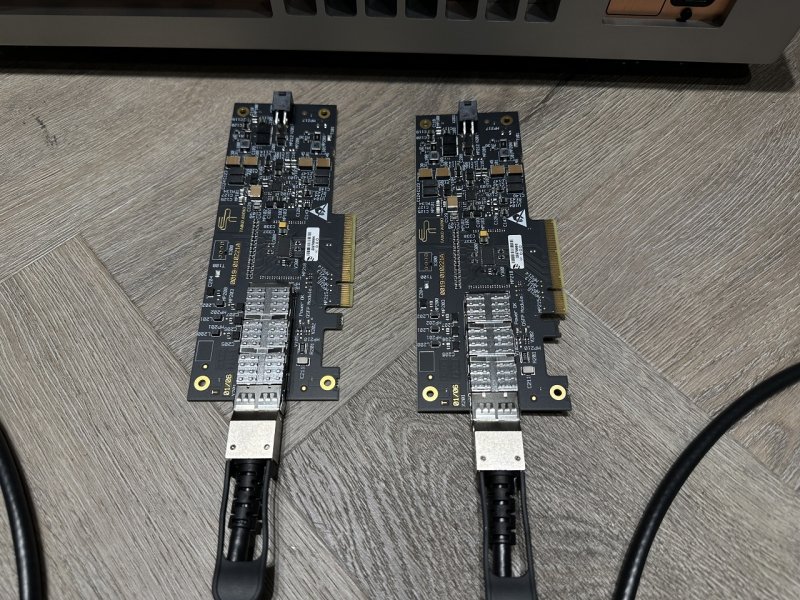

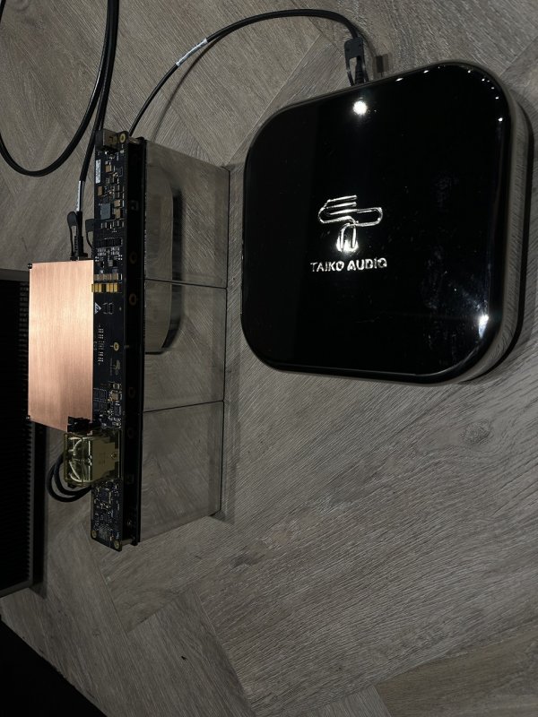

Here's an attempt at making the Olympus I/O configuration as clear as possible using photos:
On the left side we have a Switch, then a BPS which powers the Olympus "I" module, this is then connected to our new PCIe interface card by means of a QFSP cable, this card is then plugged into the Extreme replacing the internal network card.
On the right side we have an Olympus "O" module containing the XDMI interface with an analogue output module fitted, this connects to another PCIE interface card by means of another QFSP cable, this card is plugged into the Extreme replacing the USB card:
Olympus "I" module, you can see the QFSP DAC cable being substantially "beefier" then the SFP DAC cable:
And the Olympus "O" module with XDMI interface:
The Interface cards:
