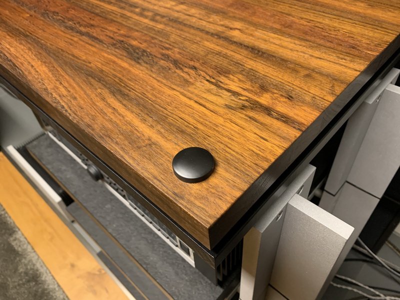

My friend drilled holes in the metal inner boards. So I can use small screws which i can counter block at differend levels to level the whole stone board, which comes the on top.
Depending on the individual case of electronics I put then foam or slices of wood between rack board and electronics.
Because I needed another level of rack for the turntable system I had to think to add a level. I want to avoid to make the large rack to unstable because of height and decouple this upper level. But without risk pushing the whole upgrade to ground. To fix the upgrade level I drilled on top of the rack small holes. When my friend had finished the rack upgrade, he added small pins in the center of the T-construction. So putting this rack on top, there is no movement horizontally.
I was thinking hardly which material is usefull is separation layer between both levels. Not too soft because of the heavy rack+turntable, but soft enough to have another resonance frequency. By coincidence I found some kind of medium to hard rubber in a shop which is normally used in tube installations of water pipes.
Unfortunately I had to make it in the form I needed....
As Aristomenis proposed there should be no stone grounding, wood is preferable.
I found these foam pads from a loudspeaker which seemed to keep the pressure of the weight, but as a different material I suppose it is good as a vibration suppressor.
As I decided to go the complicate way I use a double layer board with different materials.
Reactions: Argonaut and Glide3
By good luck I had a nice board with african hardwood Amazakoué remaining from another project. Using only one layer of wood, I feared I could get a strong wooden signature into the sound. With a second layer of wood + air between I hoped to get even better isolation to ground bourne vibrations. After all done I never heard a special signature of wood or aluminium. Seems by good luck I have done my job not too wrong.
After the using the foam pads the next layer is a board of oak, which I colored in black to get a neutral appearance in aesthetics.
Before applying the lacquer I drilled a whole into each corner of the board. Deep and wide enough to sink the screws into the board. Target is to stabilize the sandwich horizontally.
As a former work I painted some rings and end caps in black color too.
Here you can see these rings in their function to keep distance between both boards. Important is, that nothing has to be fixed too tighten in perpendicular direction. The rings don't have direct contact to the screw. Object is too cut as much vibration from the ground and let the upper board float as much as is possible despite of the turntable weight.
