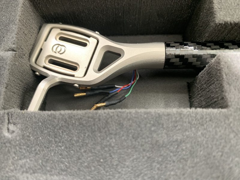

As you can see the tonearm comes in a flightbox very safe.
O.K., it should be at a tonearm of 28.000 USD, if I am correct. If you see photos of both arms, you feel this arms should be near to equal. But never saw both arms 1:1 beside. Here are some photos:
Reactions: shakti and exupgh12
You see, they from outside not really equal. And believe me, from the inside they are even more different. The principles of Resonance Suppression is the same. But the Discovery RS is much more work inside to proceed. Sorry, the details I promised to keep silent.

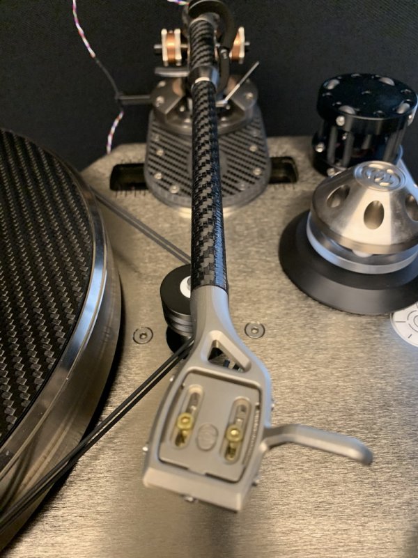

Tonearm wires look pretty thick to my eyes, maybe it's because of the way the picture was taken. Does the tonearm have an anti-skating mechanism?
Hey mtemur,
yes, this impression may come due to the short macro point of view. Under the holding arm it looks clearly thinner, but is the same size.
No, it has no anti-skating by intention. There was a reason. I had ask Louis Desjardins once, but nowadays forgotten, why.

Hey mtemur,
Thanks for your response. Maybe tonearm wires are double functioning as anti-skating mechanism but I wouldn't count on that.
Everything matters, as I had written in my report. Louis was working on the correct tension of this wire min. 15 - 20 min. until he was satisfied.

Hi 'redand gold',
Have you used a Wally Tools Skater (V2.1 or V2.1 Pro) to check for any unwanted inherent horizontal forces the tonearm is producing ie. from this tonearm wire for instance ?
FYI; I have a Wally Skater Pro and found out from using it (with the great help from Wally Tools / J.R.) that my Kuzma 4Point 11" was producing such unwanted inherent horizontal forces (with anti-skating turned off) from its very thin tonearm wire which were quite high and were being added to the anti-skating value (when anti-skating was on).
Once I had untwisted it 360 degrees a few times I was able to reduce such unwanted horizontal forces (without anti-skate) to close to zero !
Therefore if you haven't used a Wally Skater V2.1 or V2.1 Pro I would suggest you do for your new TT set-up.

+1 for the Wallytools. For such a system it is mandatory in my opinion. And JR is always willing to help if needed.

Dear Bonesy Jonesy,
I have a lot of respect for the work Mr. Boisclair is doing for the legacy of Wally Tools. I have seen his videos and explanations and the way he tried to find mechanical theories of his work.
If your Kuzma tonearm cable causes so much unwanted horizontal force, then unbending the cable is a way. But a risky one, the way this cables are thin and breakable. And what would you do if the cable is inside the tube. No way of turning it.
I can't confirm that I have unwanted and too high forces horizontally. In my case it is in a balance to the inherent skating forces and the system sounds fantastic. What matters the most for me. Yes, there is an effect of this cable, but not a problem. IMO there are some other factors like SRA, VTF or Azimuth which are much more important.
