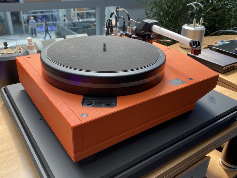

A few photos from Munich High-End 2022.
38392FBE-2580-41E0-9DC5-A3888B34C066.jpegD2ABF236-AD18-47D0-8942-0DF01E023E2B.jpeg913FF477-1396-4E59-8606-EED9CB112B57.jpeg
Quick questions. Is the headshell removable like the 4Point? Is there a dimple at the top of the arm marking the pivot center point so as to allow the use of my P2S measurement tool? Don't see one in these pics. Might not make any difference if used in one of Kuzma's own tables but if used on another table it would be most helpful.

some more pics from Munich
58A8A4E3-014F-45A3-99C9-6EB3B6877FCE.jpeg1FC9D1D7-6A78-47F9-8A86-37D0EE708EA3.jpegABE66B6E-0A3A-407F-8169-BCB12AA63B33.jpeg900C3D11-6810-43B1-B8E2-ABD4E06DD06F.jpeg
playing,
but I could not manage to be their at the correct time, the other player is GP Monaco with 14“ 4point.
