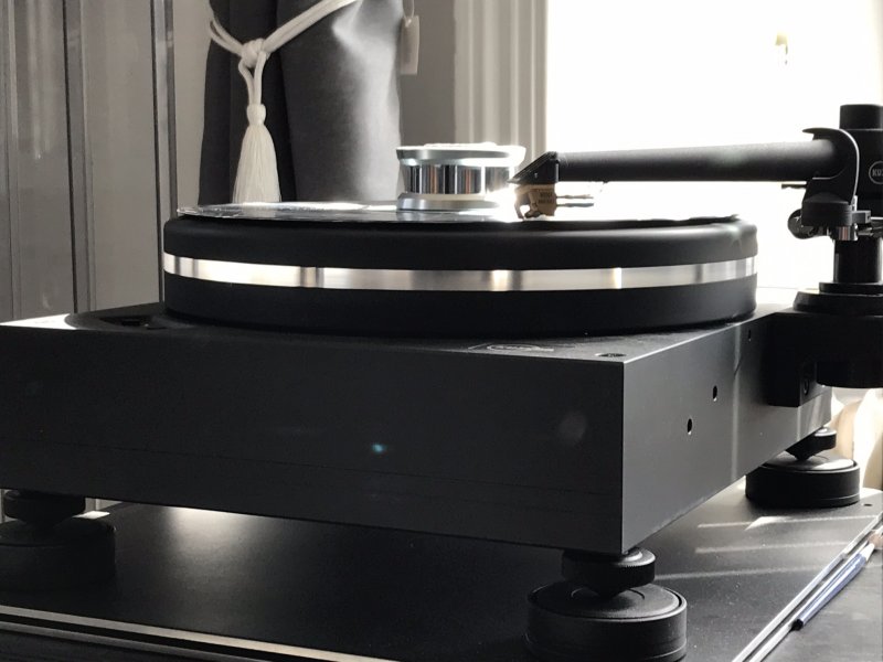

Wow! Way of my chart money vise. But so cool, some people don’t appreciate the Kuzma functionalism “Star Wars Imperial style” design but I love it.
It would look nice as a second arm on my Stabi R.
