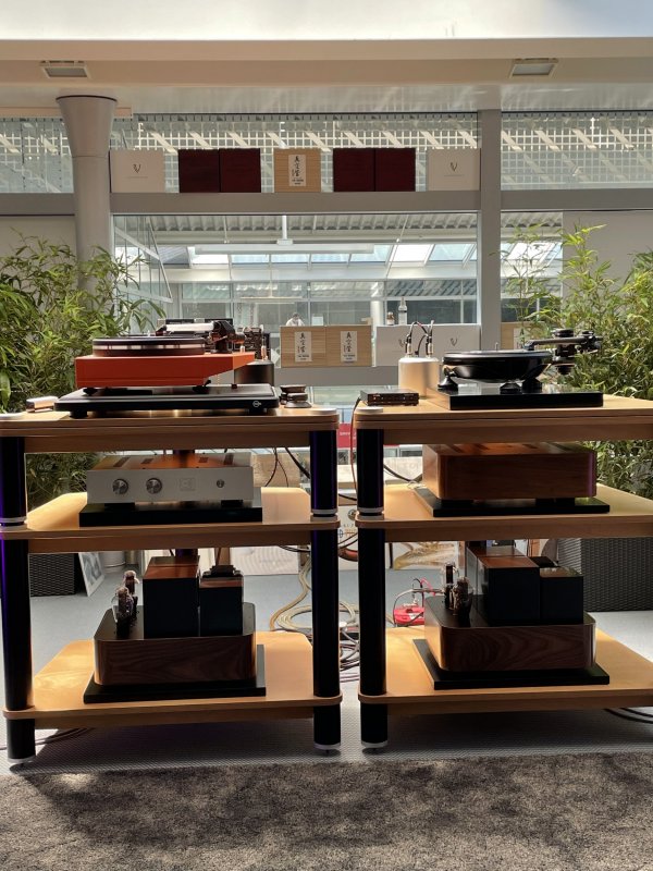

What are those amps?
The amplifiers are made by Simon Shilton. (who is a long term friend of Kevin's at Definitive Audio)
I believe Kevin has 'voiced' the ones he uses and sells through selection of some of the components.
