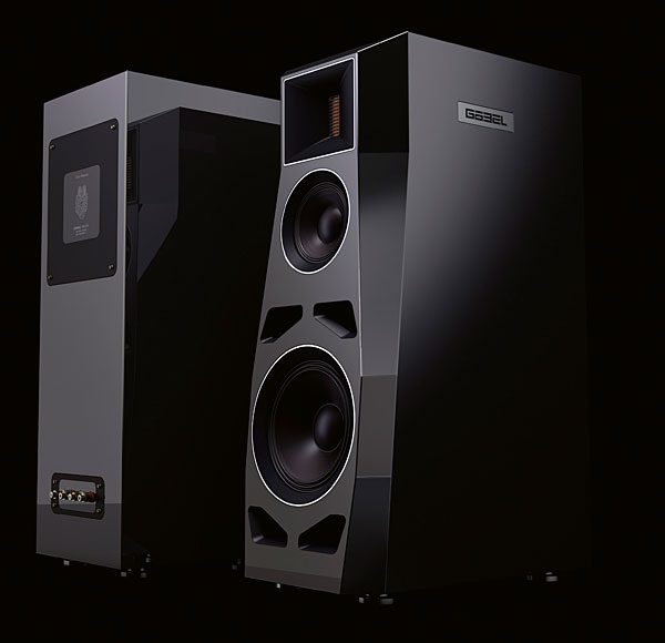

they aren't quite as sensitive as they appear - nor have simple crossovers. 89db, with amps required that drive below 4 ohm loads, dropping into 2 ohm territory:
JA also adds color with Lamm hybrids in the review at 1-6 ohm setting.
Now, this has nothing to do with how Gobels sound, just amp pairings. For SET, I want 8 ohm speakers with 6ish minimum for optimization. Gobels were driven on ARC 160s last year at Axpona.

I think amplifier/speaker matching is different to the subject of “sufficient power for driving speaker” so no one can predict/guess about the sound of Goebel/Lamm without listening.
A big 500w/8ohm high feedback solidstate amplifier can drive paper driver of audio note AN-E 92db but the sound is awful.
Numbers in specs are not the whole story.
Stereophile :
Göbel specifies the Divin Marquis's sensitivity as 92dB/W/m; my estimate was a little lower, at a still-high 89.5dB(B)/2.83V/m. The Divin Marquis's impedance is specified as 4 ohms with a minimum value of 3.4 ohms at 95Hz.
it means the Gobel sensitivity is 86.5db/8ohm
