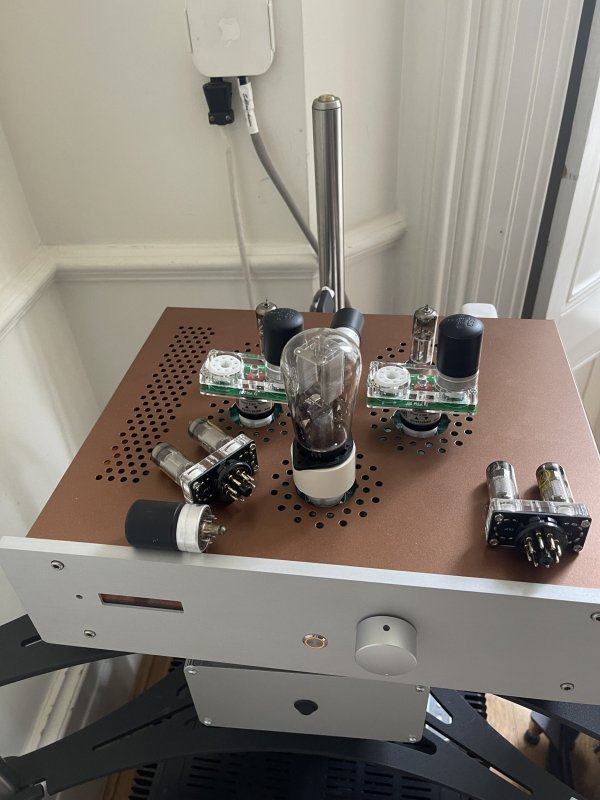

Line up the tabs and then push the tube directly down onto the adapter using the palm of your hand. Push it straight down, not at an angle.
It takes a bit more force than you think. There is an initial resistance while pushing down and then it just "pops" into place and will be seated very firmly once it pops in.
As for the loose tube base, one of my Valvo AZ1's had that same problem. It should not impact operability, but I understand you can use super glue to fix it (I've never done it myself, just what I read online but please confirm).
Sorry but i think that advice with that particular socket/tube base is wrong. Pins on the tube should be aligned and placed under coresponding “tabs” in the adapter under the angle and while holding the tube for the base you just straighten it up and it should nicely snap into the adapter without almost any force used…

Hello Guys,
Just received my Valvo AZ1 + Adapter, I cant make it to insert into the adapter, I feel if I push harder enough I can break the glass. Any hint ?
Plus there is this "loose" on the Valve base, is it normal or something to worry about ? Video attached
Thanks !
You are not alone. Honestly, I thought brain surgery was easier. It wasn't until Goran helped me out by pointing out that the 4 pin side gets fitted first, and then comes the push down to get the other side set. Once you "get it", it's doable,. Still, not the easiest adapter I ever saw :confused:
I agree with you all, it took some attempts to make it, but once it's in it stays put, no chance that it's going to fall out.... ;) I was even so happy that I bought 2 of the AZ1 adapters so I didn't have to remove it when trying another tube, haha! not sure that's even possible....
ECC40 rimlock adapters were almost worse though, there it really felt like the tube was going to crack and you had to be very careful.
Adapters ftw....
Hi Goran,
Hmmm, I have two of these adapters and multiple AZ1's both Valvo and Telefunken. I line up the tabs (I start with the closely spaced tab side), then push down. Both of mine require some initial force and then they pop into place. Not a ton of force, but they definitely don't slide in effortlessly. Perhaps I am doing it wrong but it works every time but I defer to you.
Gotcha, I'll try that next time.
I tried going vertically long time ago with some other tube (can’t remember which one) and was a no go as it seemed tons of pressure is required. Going on, as i advised (under angle)and as Mark wrote holding the tube for the base there was literally no force needed to place it into the socket. Pulling it out of the adapter vertically is even worse while under angle it works like a charm (for me at least).
Cheers,
G
I just used that method and both of you are right. Much easier. Thanks for the tip.
I am also curious about @Miki70's loose tube base. I have a Valvo AZ1 with a loose base and some internet searching said it can be re-glued and I see some used ones for sale with what appears to be tape on the base.
I haven't tried to fix my loose base, but curious if others have done this and if so, if they have any tips?
