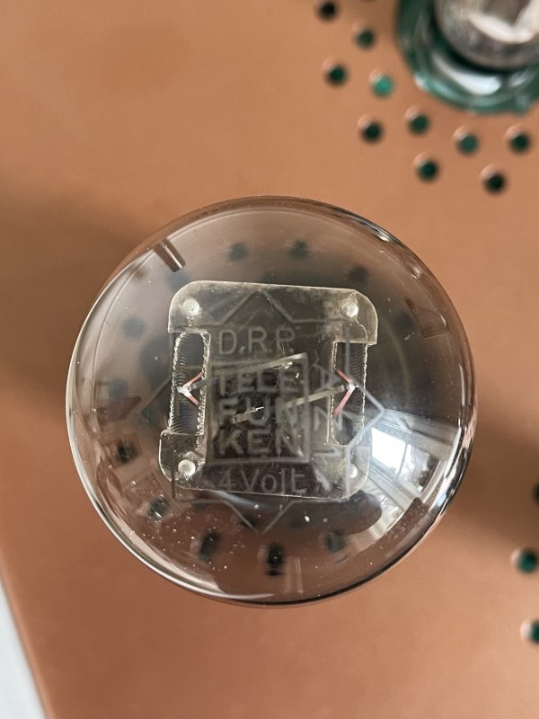

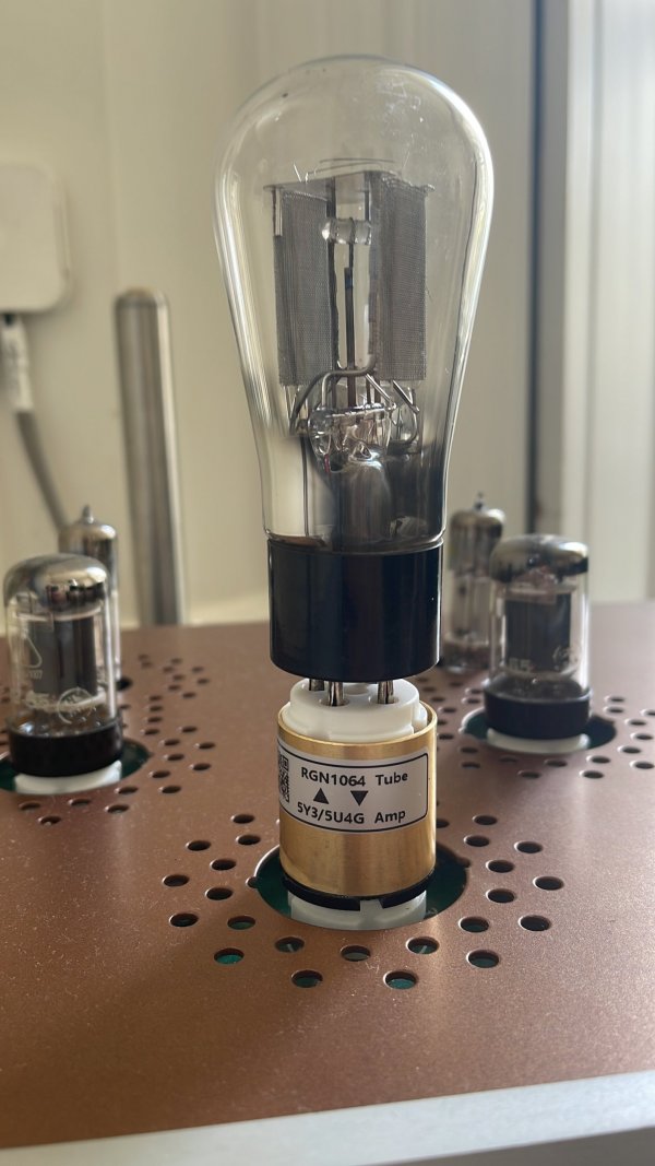

Telefunken rg1054 from 1934. This is the predecessor of the rgn1064, which then spawned the AZ1. Sounds good and clear, even with a brand new adapter needing burn in.

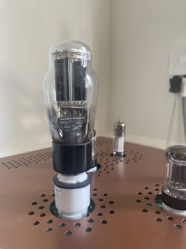

I fired up the Tungsram pv200/600 and had a very quick listen. It doesn’t suck. In fact it does some things better than any predecessor. Brand new tube with brand new resistor damped adapter so it’ll need some burn in time.
Just put this tube/adaptor in my Atlantic TRP and its really nice! Seems to equal more expensive NOS rectifiers in my experience.
