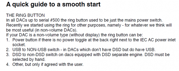

Hi..I was about to play both DSD256 and DSD512 on my GG. Last month, I got many files mixed between multichannel and stereo. This morning, I have removed all multichannel files and stick to stereo alone. However, when selecting either DSD256 or DSD512 (only 1 file), there is only noise, no music. My GG has optional DSD512 built in.
There power switch is at the rear panel. On the front panel, there is a ring button. Now, if I un-press the button, only noise come out. But if I pressed it, there's total silence. I still can't figure out what the function of that ring button.

as far as pressing the ring button, if the light is on then the dac should be on........unless you are switching from dsd to pcm.......maybe.:rolleyes:
likely the ring button on your Golden Gate takes the dac into and out of 'stand-by' and lowers the power to the tubes to standby. however......one of the fun parts of Lampizator is that any damn thing is possible since they are all custom built.
so.......you really need to ask Lampizator what that button does on your particular unit. fun huh???
maybe there is an owners manual specifically for the Golden Gate......but if so I've not seen it. again.......every week it seems there are changes.......so one needs to ask to be sure about things.

So at the moment, the ring button on my GG is still a complete mystery. LOL.. now checking with both Auralic and Lampi as to what might cause this problem.

no exactly.
from your description above it seems very likely that the ring button does turn your dac on and off. technically probably in and out of stand by. which means when you get noise the dac is working. likely a setting somewhere in not set right.
good luck.

Pressed in, it's off. Unpress, it's on. Seems rather awkward though.
is the light on or off? that should be the cue.
Lampizator is not super elegant industrial design. it's functional and classic.
not meant as any criticism as I like the Lampi approach just fine. but there are more esoteric approaches to doing things.

The light on the ring button is always ON regardless of pressed or unpressed.
ok, now we are getting somewhere. if your light is always on, then likely that ring button toggles something, and I'd bet it's back and forth between PCM and dsd. so that means that 'no noise' might be related to your server and what it's outputting. if the server only is outputting dsd then when you switch it to the PCM dac it cannot even get noise. or vice versa.
that was all just a guess on my part.......you need to contact Lampi and get clear on what that switch does. the problem is likely in data delivery from your Auralic.

it's also possible that you have multiple digital inputs, and you need to have a separate input for PCM. if that was the case, when you switch the front ring button to PCM there is no signal to even input to the PCM dac so there is no sound.
again, just a wild ass guess. my particular Golden Gate is dsd only and only has one digital input. so I have no first hand knowledge.
