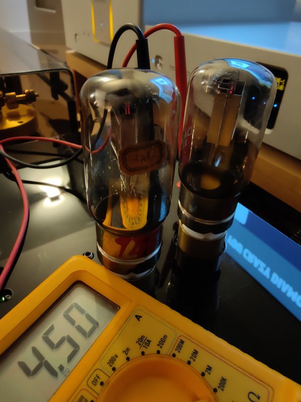

VISSEAUX R86: 4.5V; 0.3A -> 101D setting (adapter needed PX25 to UX4)
Thanks Justin for pointing out to these tube options!
I think R86 is RadioTechnique and 4.5V 1.0A same as Philips 4606.
101D setting should be OKish for it.

On the block. Metal base Radio Technique R86. Non-metal is available.
2 hours in and obviously fantastically euphonic with rock.
Lowish gain, before people ask, because it's important to people, obviously.
Susceptible to RF from an Amazon Firestick.
These measure great but have obviously seen a lot of use over the years. Love that they've seen massive use and still make it on the test bench. Sign of true quality.
A definite fleshed out, generous, sound great quality is obvious. Does a fab Whole Lotta Love.
Reactions: Golum
Pneuma by Tool on Amazon Music Ultra HD via R86 just phenomenal. All 11:53 of it.
Big, boxy metal plates just love metal, obviously:)
