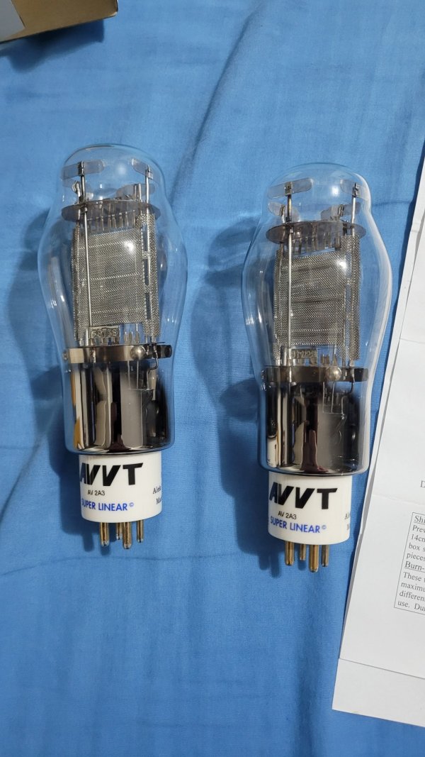

Question on the balanced Lampizator Pacific DAC. My Pacific has a five position Rotary Switch that allows you to roll tubes. Position One is labeled, T-100, 300B, Pos Two is PX25, 101D, Pos Three is PX4, Position Four is 242, and Pos Five is labeled 45. I have used successfully 242’s and 300B’s; and they do sound noticeably different! The Manual indicates that 2A3 tubes can be also used but Which Position from above is the correct option?
Double check that 2A3 reference in the manual.
I don't believe 2A3 is compatible with the Pacific. IIRC, it was compatible with some other, older DHT Lampi DAC's, like the Level 7.

I could be mistaken, but, I *think* I inquired some years ago to Lampi Poland, as I have some cool AVVT 2A3 mesh plates I wanted to try in my Pac2, but was told no dice? But yes, let us know what you find out.

2a3 are not compatible with my B7 MkII.

Okay, thanks on that. When you select the Big 7 MkIII on the Lampi NA site, it mentions 2A3, but maybe that is only MkIII?
Use the 245 setting.i didn't have a problem with my pac before

Here’s the exact answer from Lampizator Support. NO, you should Not use 2A3’s in the Pacific DAC:
Per our tech: there is no best setting for 2A3 in the Pac or any other DHT DAC, unless it's customized - at the expense of other standard tube(s) (300B, T100, 101D, PX25, PX4, 242 and 45) that we officially support.
If someone tries to find by experimenting, one could burn the filament circuit power supply or burn the tube or get the filament operating point far from the standard 2.5V 2.5A.
