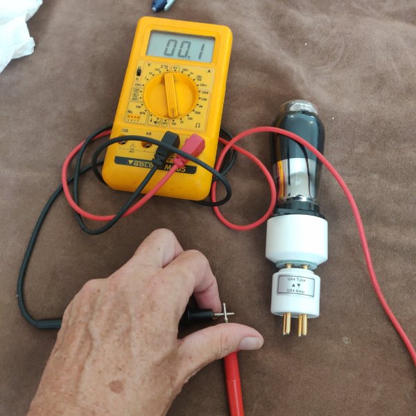

Right, here's what I just did.
First I measured the resistance of the multimeter leads by touching them together.
Then I measured the filament resistance thus. It's low Ohms and the result is a bit variable because of it I think. Some pics to show variance:IMG_20200819_152033.jpg
What you are supposed to do it subtract the lead resistance from the filament measured resistance so let's say we have a 1.9 Ohm filament from those readings.
Then I measured the voltage. You see two shots with each OJ date code AD1n in the same slot. In my tube tester they both measure 6mA/V if I remember correctly.
They both measure bang on the same voltage here. A bit closer to spec than David's Pac, but hey, the guy who did my DAC is freakin' awesome, LOL.
So, from V=IR we can deduce that 4.53 / 1.9 = a current of 2.38 amps. Which is pretty closeish to spec.
So that's pretty good as far as I am concerned.

More interesting information.
On the "bad" tube I am getting a resistance of 1.4. The meter is .1, so the true resistance is 1.3.
Based on a voltage of 4.099, the implied current is 3.15 amps, which seems high.
On the good tube I can't get a reading. The meter just reads OL on one meter and no reading on the other.
I think what I am concluding is that the "good" tube is bad and the "bad" tube is fine.
