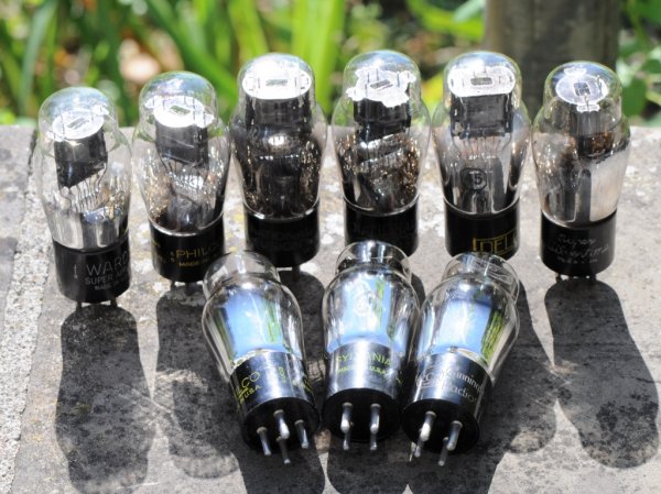

Talking of Amperex, I have scored a pair of Amperex 45s.
Thing is I am not sure they ever made them. They might be a rebrand, but I cannot reconcile the internal structure with any 45 I have seen, including Thomas Meyers excellent 45 page.
Should have them next week.

I'll test these and slap them up against EML GM 45s and see which I prefer soon.
These do look to be Amperex but if anyone recognises the internal structure from another brand please let me know.
Hard to get excited by 45s but I rate Amperex highly. These could be very good. Maybe;)
View attachment 70260View attachment 70261View attachment 70262
Look similar to those branded Philco, Ward.. or Super Silvertone. All made in USA.
Take a look:St-various.jpg
picture from http://vinylsavor.blogspot.com/
Well even the wife is complaining. These Amperex sound shit.
Onto the tester soon to see if anything is wrong technically.

I think I remember throwing my good Philco in the bin when one went bad. The Amperex are the same internally, though, definitely.
They actually measure super strong at 3 and 2.8 mA/V, where new is 2.1 mA/V.
