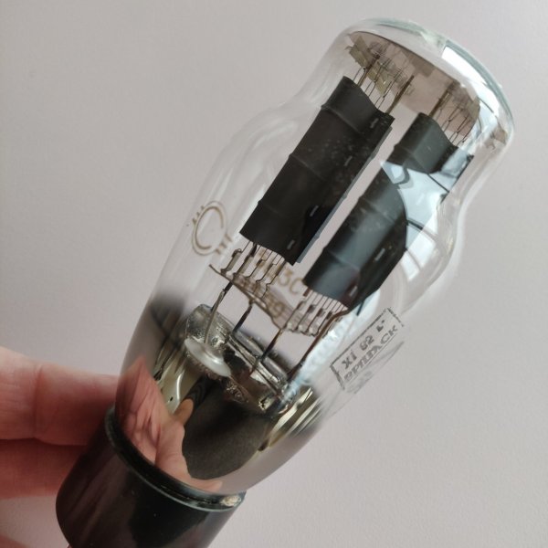

Soviet block with the 5C3S rectifier.
An unbelievably cheap 5U4G.
Isn't that the rectifier the Lampi entry level models come stock with?
IME ok but nothing special :p

A 5C3S rectifier has arrived. £13.99.
I can now go fully Soviet block: 6N6P->5C3S->6C4C.
