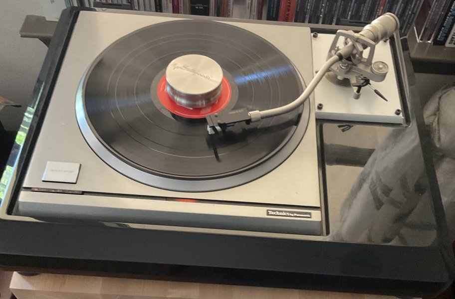

Few old pictures of mine (from about 15 yeas ago):
With Kiseki Blue Goldspot
And the back end of the EPA-100.
Best regards, Tony

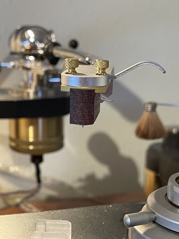

just a small update on the vintage cart track
got a Kiseki NS Purpleheart a few weeks ago and despite it´s not supposed to be up to the NOS I quite like it
so when I spotted a NOS Purpleheart Saphire in Denmark, I just couldn´t resist and I installed as fast as possible, when it arrived yesterday...
All the Kisekis are installed in original Ikeda headshells in the IT-407 silver on the B60 base on Melco, so very easy to compare the different models
temporary conclusion is that the Saphire is great: fullbodied, fast and with fantastic harmonics and extension in both ends
makes me wonder about the Kiseki Agaat....ha-ha
