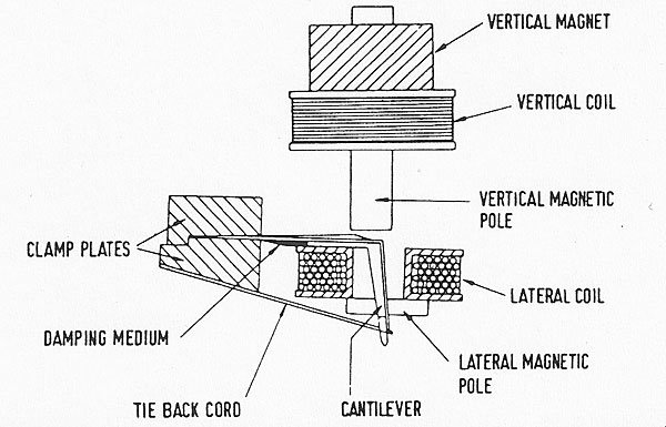

Hi Bruce,
Yes indeed it is really bloody hard to see what is going on under there because of such low clearance and the lack of any protruding cantilever.
In terms of VTA/SRA - realistically it must be mainly SRA that one is adjusting when changing the height of their tonearm base since the pivot axis to the back on the Decca’s internal cantilever will likely has extremely low compliance vs normal cantilever designs. Indeed I think the lack of compliance here is what many regard is one of the parameters that gives Decca such explosive dynamics - specifically that no vibration is lost in heat etc at that soft rubber joint. Below is an internal I pinched off the web:
Anyway I digress - so effectively it is largely the SRA that is being adjusted when one manipulates their VTA tower imho. Decca recommendation is to set it so you riding just slightly low at the tail, which seems almost inconceivable when you see how low and flat it is to the vinyl anyway.
In terms of whether you can get a usb microscope in there with Feickert software a la Fremer method - I am not sure if possible or not but I would imagine with the right microscope possibly. I have always used my ears to set it. It shouldn’t sound dry or thin - if anything it is super generous in the lower mids when dialled in.
For Azimuth - I do that with a tiny level as I don’t own a Fozgometer but the latter would be really interesting just to see how sensitive or not the cart is to this parameter.
I am afraid my setup is somewhat old fashioned and crude by modern standards and it does take much longer to get it really singing and you’ll lose a few hairs doing it but it is so worth it.
