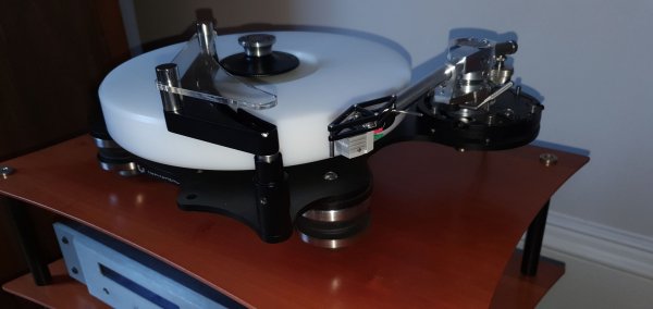

Hi Urs, I don't have a Jubilee, but have a Reference, and am happy to share my experience.
I've tried the Reference on a number of arms now, including a 12" Ultracraft AC-400 oil-damped unipivot and a 9" SME 3009 (pre-improved). I couldn't really get it to sing on either.
By far the best results I've achieved have been with a new Townshend Excalibur arm, using its front-mounted oil trough:
Using a test record, I can see LF resonances pretty much disappear with the oil trough engaged.
It was a total PITA to set up, due to the tip being so far forward on the cartridge body. But as other people have suggested, it's worth persisting with, as the sound can be truly sublime - dynamics and sheer slam to die for. (And I have zero issues with tracing.)
Good luck!
Mani.
Is this the Decca London Ref? A cart that really splits opinions...I know how I feel about it.
Marc, I tried the Reference on my Transfi T3Pro (when I still had it) and it sounded truly awful - a match made in hell. My experience was that the T3Pro sounded best with high-compliance cartridges (MMs sounded good), which the Reference certainly isn't. If that's the only experience you've had of the Reference, I can only say that you've not heard it at anywhere near its true potential.
Mani.

Ironic really, Vic developed the arm mainly with the London Ref on it. He's since moved onto MM carts.
Yep, and that's why I bought the T3Pro. It was clear immediately that the T3Pro, with its linear air bearing, simply wasn't providing enough (any?) damping for the Reference. But I must have heard some of the Reference's magic come through because it has stayed, whereas the T3Pro has long gone. (Nice arm with the right cartridge though.)
Mani.
Mani.
Yes (to your last comment in brackets).
