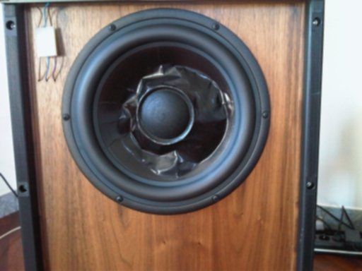

As to the woofer change, I think Roger Sanders has at least implied the same thing to me in private correspondence as to his opinion of the relative quality of the previous woofer versus the current aluminum woofer. He did state that the primary reason for the change was to prevent overzealous customers from destroying the woofers. He provided pictures of blown woofers of the earlier type and those pictures were not pretty. See this picture, for example:
As to the mechanical woofer noise problems I had with my prior 10c speakers in my former house, perhaps some of the noises were caused by interaction of the sharp spikes Sanders provided and the solid concrete slab floor beneath the carpet in my basement listening room. At the time, though, I attributed most of the problem to the amount of bass boost needed to bring the woofer up to the level of the panels all the way down to 20 Hz. Perhaps I was expecting too much bass extension. With the 10e's I have the bass boosted down to 25 Hz from which frequency it is allowed to roll off naturally.
The major problem with the 10c, in my opinion, was the high noise level--mostly quiescent hiss--generated by the Behringer DCX2496 crossover unit Sanders was then using. Honestly, I could clearly hear the hiss with no music playing from several feet OUTSIDE the music room door. Nothing I tried reduced this hiss. Sanders was at a loss to explain it since he heard no hiss from his own personal 10c system. He did admit, however, that he usually listened with his windows open, so that means his ambient noise level in the listening room was far higher than my very quiet, below-grade basement listening room.
This 10c hiss was totally eliminated when I eliminated the Behringer crossover unit and pressed my TacT RCS 2.2XP AAA into service to control the crossover and EQ. The sound quality notably improved in all respects and the hiss was totally gone--not audible at all even with my ear right next to the panel.
In my view, the current dbx VENU360 control unit is a HUGE improvement sonically and every other way over the Behringer. Overall it is by far the best equalizer box I have ever used, not to mention the most flexible crossover unit I've ever used. The fact that the 10e sounds so transparent is evidence enough of the dbx box's sonic transparency. And there is NO hiss when the system is properly gain structured, which the dbx controls easily allow--even from my near-field listening position.
In my view, the weakest aspect of the system--and this aspect is still very good--is the woofer driver and/or cabinet noise. It is still easy enough to induce mechanical noises which are very easy to hear at less than deafening levels and even with any additional bass boost eliminated--straight factory set up, in other words. I no longer use pointed spikes, just the flat feet Sanders also now provides.
To easily hear the noise, I just mute the output of the panels via the dbx controller app (takes only a couple of taps on my iPad screen) and listen to the woofers alone playing material with strong low bass. I can hear mechanical noise from the bass driver and/or cabinet at high but not unreasonable volumes beginning at between 84 and 90 dB or so. To be clear, however, this noise is not usually audible on any classical or jazz recordings, only with electronic music or heavy rock recordings.
Turn on the panels, however, and all such noise is totally masked even up to far higher volumes. Thus, the woofer is plenty "good enough" in my book for the volumes I use and my usual classical and jazz music fare, which generally don't exceed about 84 dB.
But many speakers exist which never produce any such mechanical or cabinet noise even with extension down to 20 Hz and the ability to play at high volumes down there. My Dutch & Dutch 8c speakers are just one example. I've never heard those speakers produce any spurious noise of any kind even at ear-splitting levels above 100 dB with any kind of music. By the way, I'm being careful to distinguish whether the bass-induced noise is coming from the speaker, or the structure or other contents items vibrating within the room. While the room and objects within it also can make spurious noises, the Sanders woofer driver or box itself is making some of the spurious mechanical noises I hear.
