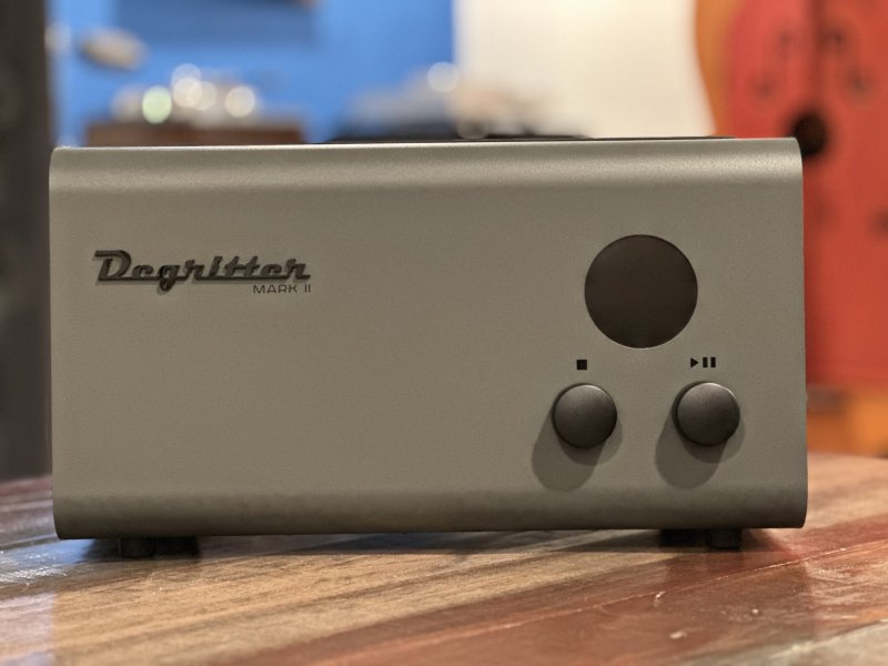

My new Degritter Mk2....

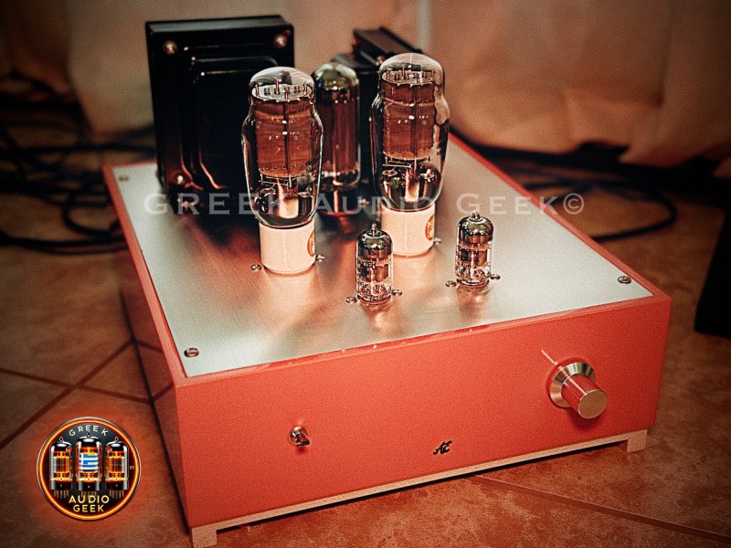

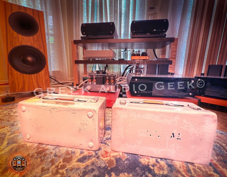

Going to be trying a 2A3 that is available either as a kit or pre-built (I did pre-built as I don't have the time nor space to try and build an amp).
It's the Analog Ethos 2A3 Legidarium.

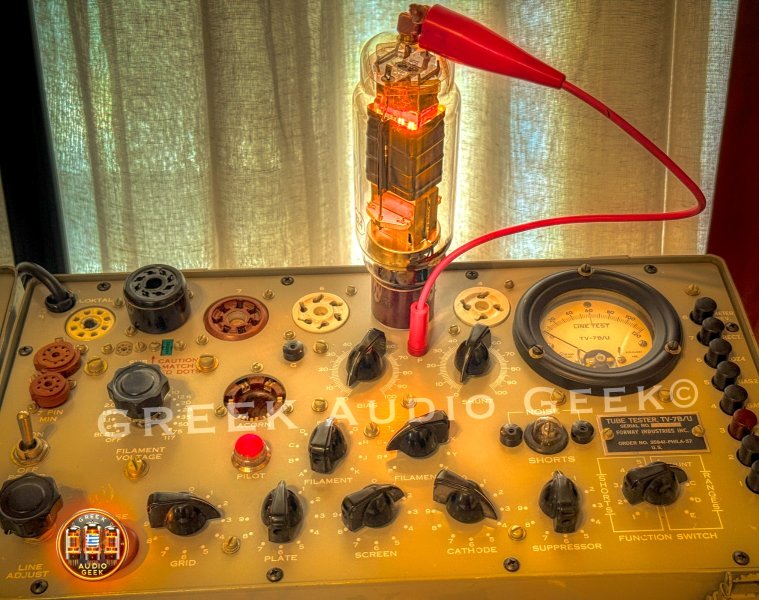

Out of curiosity, what type of information does all that this testing provide? Could you not detect a defective tube just by listening?
Hi - great question.
I personally use the testers for a couple of things (I think different people use them for different info).
I'm going to first test the tube BEFORE I put it in my gear to make sure it doesn't have a any shorts or a gas issue so I don't damage my gear.
Then I'm going to test its relative strength compared to a rough (I say rough as it's never exact since it's based on variables) "when new" rating since I buy vintage tubes and pay based on how strong they are.
For instance in just the last two weeks I had one vintage tube I bought that failed these tests on the tester, and I had a pair of type 45 tubes that were supposed to be close to new specs but tested 1/5 what they should have been. It was clear they must have suffered shipping damage. In both instances I was able to send the tubes back.
I also had an issue with one of the tube amps where it kept blowing fuses. Rather than replacing all 6 tubes, I simply stuck them in the tester and was able to ID in about 2 minutes it was a rectifier that had gone bad.

I would suggest though with something like the Jackson 648P (stupid simple to use and gives you useful info) or even my military TV-7's, they don't require a radio veteran to use them properly nor derive extremely useful info.
I'm amazed at how accurate my Jackson is with its simple "good or bad" scale when compared to the TV-7.
