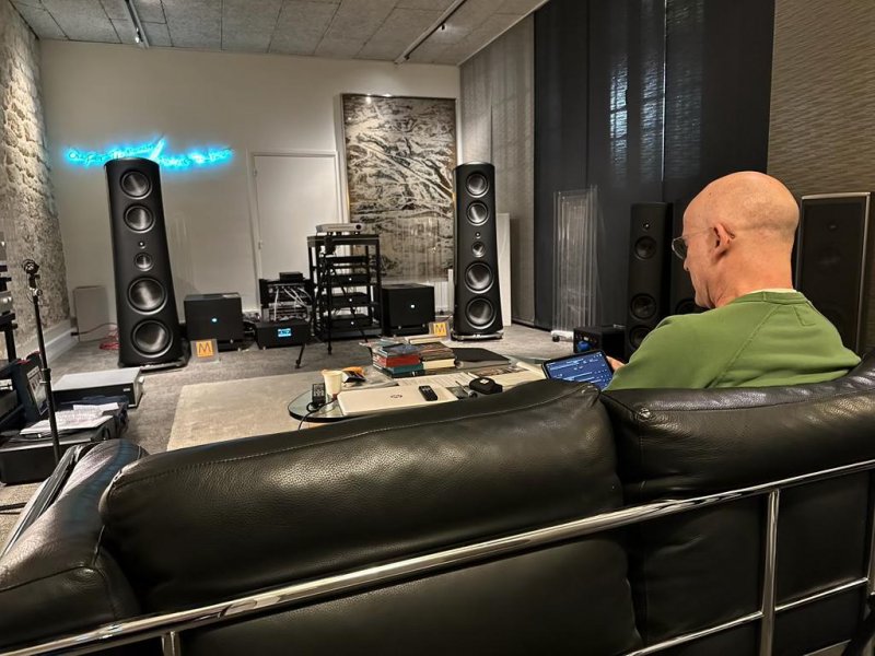

Alon Wolf oversees the final in-room setup of the Magico M7 speakers at Présence Audio Conseil in Paris, France.

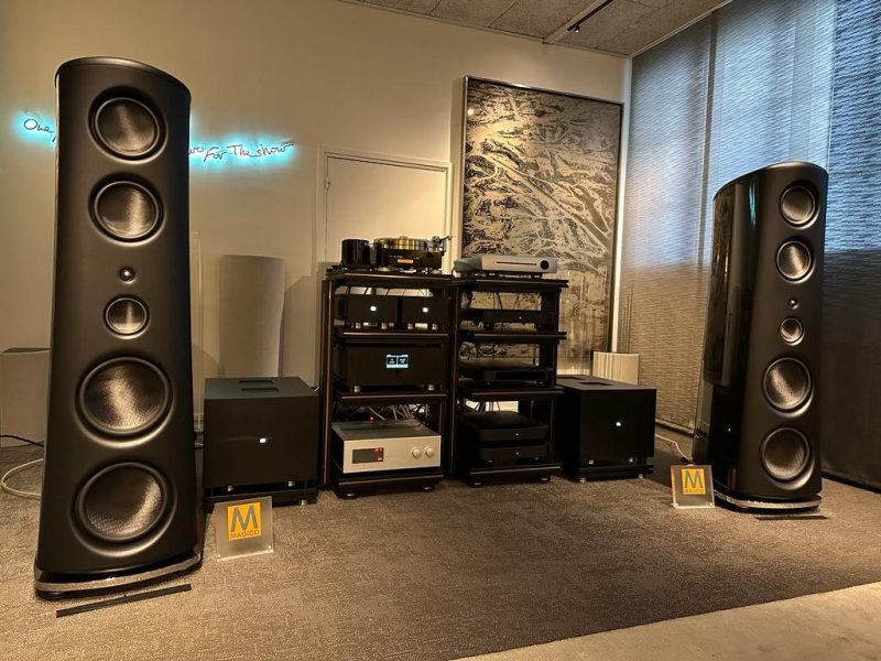

The Magico M7 makes its worldwide debut at Présence Audio Conseil in Paris, France.402629515_777197314446760_6573533600919309923_n.jpg
Showtime!
The Magico M7 makes its worldwide debut at Présence Audio Conseil in Paris, France.View attachment 120018
WOW! These pics give some better idea of the size of these new speakers. I really like the overall shape and scale for more typical listener room sizes. The M9s really demand a sizable room, the M7s ought to play well in somewhat more modest spaces (like my room ;)).
