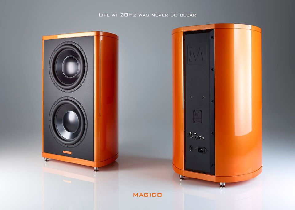

1) Has anyone compared in a familiar system the sound of a Q-Sub or S-Sub to the competitors such as JL Audio Gotham or Velodyne DD-18+ or REL No. 25 or REL G1 or REL Studio III (available used but no longer in production) or Seaton Submersive or Seaton F18 or Paradigm Sub 2?
2) Can someone who owns or sells Magico subwoofers please tell me if they can accept speaker level inputs (which is the REL connection method)?

I'd like to know the answer as well Ron as I've been pondering subs to get me solidly below 21 Hz again for pipe organ and other types of music where there is true content down in that region. I've just scoured the Magico site, the single review on the Q-SUB and cannot seem to find these facts, a product manual or anything.

The S-SUB does not have a speaker-level input on the back. I can't tell on the Q-SUB but strongly suspect the same. Since virtually all active subs include an amplifier as a single unit with crossover and low-level electronics before it, the speaker level inputs simply use a resistive divider to reduce the signal to line level before applying it to the same signal chain as the line-level inputs. Your REL may work differently or not, but if you want to use speaker-level inputs into a line-level sub input, all you need to do is to use a simple passive divider (you can buy inline attenuators, passive gain/volume controls, or build your own).

2. The S-sub has line level inputs, and the Q-sub appears to have the same set of inputs. Maybe they can be ordered differently but I wouldn't expect it.
